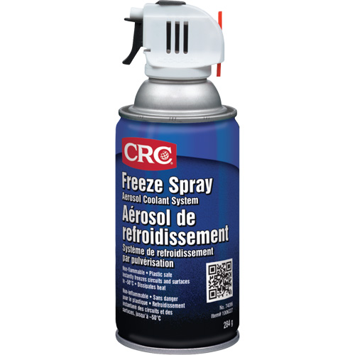

I don't waste freezer time, I use this instead. Parts shrink more due to the lower temperature and thus fit easier.
