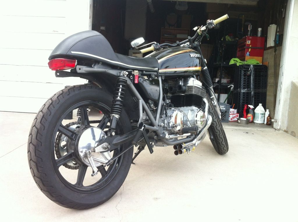

Thanks guys...I wonder if it'd go over my tail light of not?
Same tail-light for both tank/seat setups

« Reply #5 on: August 13, 2015, 01:52:46 PM »
It looks like it would hit the taillight in the top photo.
Re: 1977 + 78 CB750K Grab bars
« Reply #6 on: August 13, 2015, 02:33:21 PM »
Looks to me like it would clear it. You need to get some measurements.
Offline doobiebro
  • Posts: 127
« Reply #7 on: August 14, 2015, 07:42:31 AM »
By your pictures, it looks like it may clear the light.  If you get one and it doesn't line up the way you would like it to, you could always put the bar on upside down to be sure it clears the light.

I found one...and I found this photo that makes me think there will be no issues. Finger's crossed (it's still in shipping)
My Brown seat is on a stock (cut at the front) 78 pan...
