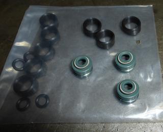

Can someone please tell me where these black seals go? I can't find any reference to them.
thanx.

Under the head but only on some years.

Used on late 750's and they are sealing bolt packing with PN 12115 300 000
Number two
https://images.cmsnl.com/img/partslists/honda-cb750k5-four-1975-usa-cylinderpiston_bighu0105e1305_df86.gif

Alright,thanx guys...
I have a K5 so looks like they are needed lol.
