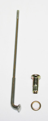

I received my CB750A front and rear spoke sets from eBay seller: Vintagecb750online, they arrived Wednesday with a return address from Parts N More in Stratford Ontario. I find them from PartsNMore for (US Dollars) $40/set, their international shipping to my door in Mass. estimates at $9.95 which totals at $90.95
From EBay with sales tax and PayPal fees the 2 sets totaled $104.23
Now to find some oven cleaner to get the anodize off of the 2 sets of CB750A/GL1100 wheels and choose which will go on the K8.
« Last Edit: April 09, 2021, 04:53:06 PM by Alan F. »
