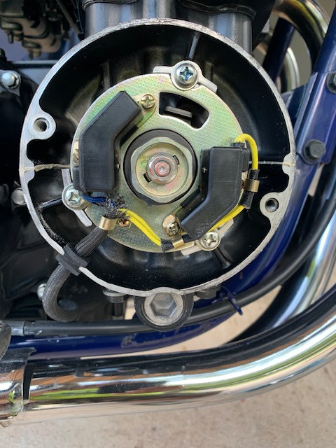

I took my ignition cover off and compared to yours. There is nothing that looks different from yours aside from mine being a bit dirtier. As long as your timing is set, maybe check your CDI units (though they either work perfectly or they don't work at all), coils, and battery cables. I guess? I think the other thing that's affected at speed is air delivery.  I'm wondering if something is causing a bizarre air starvation effect as you go faster? I'm throwing darts at a board from a mile away with guesses now.

Is there a resistance spec for your ignition pickup coils?
Have you looked at the mechanical timing advanced?
From the FSM:
  • Coil resistance: 530 +/- 50ohm (20c, 68f)
  • Between yellow with white tube and yellow leads (2,3 cylinders)
  • Between blue with white tube and blue leads (1,4 cylinders)
Here, I've linked to the FSM's super thorough troubleshooting guide

Is that the Pickup Coils behind the timing cover?
Those are called the Pulse Generators. Then underneath the seat, next to the battery, are Spark Units / Ignition Control Modules. Lastly, the coils are attached to the frame directly under the front of the fuel tank.
