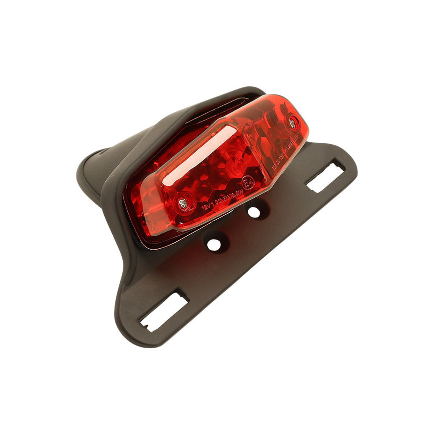

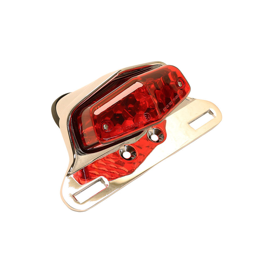

I'm not sure honestly. My original plan was to focus on function and ignore appearance for the most part, but paying a nominal fee so far for vapor blasting has been an efficient way to clean things up. My best guess is to not paint them, just use Sharkhide. I have in the minds eye to do the frame with this color here, a flat finish single stage urethane OD green, and then do body in a dead flat black urethane.
 https://www.amazon.com/Olive-Drab-Green-Urethane-Automotive/dp/B00BPF405U
Not sure on fenders...I saw a post where a guy showed how he removed the welds on the rear fender bracket, rotated forward and then re attached the bracket, then used a Lucas tail light, that looked pretty sharp.
http://forums.sohc4.net/index.php?action=dlattach;topic=194645.0;attach=492535;image
Just not sure if that fender should be chrome with a chrome light, chrome with a black light, flat black with a chrome light :-).
Kinda leaning towards chrome because I have a front one that cleaned up decent after a bath in evaporust. So that leaves me to pick chrome or black lucas light. I'd suppose the headlight brackets remain chrome too. Those might balance well with blasted aluminum lowers.
