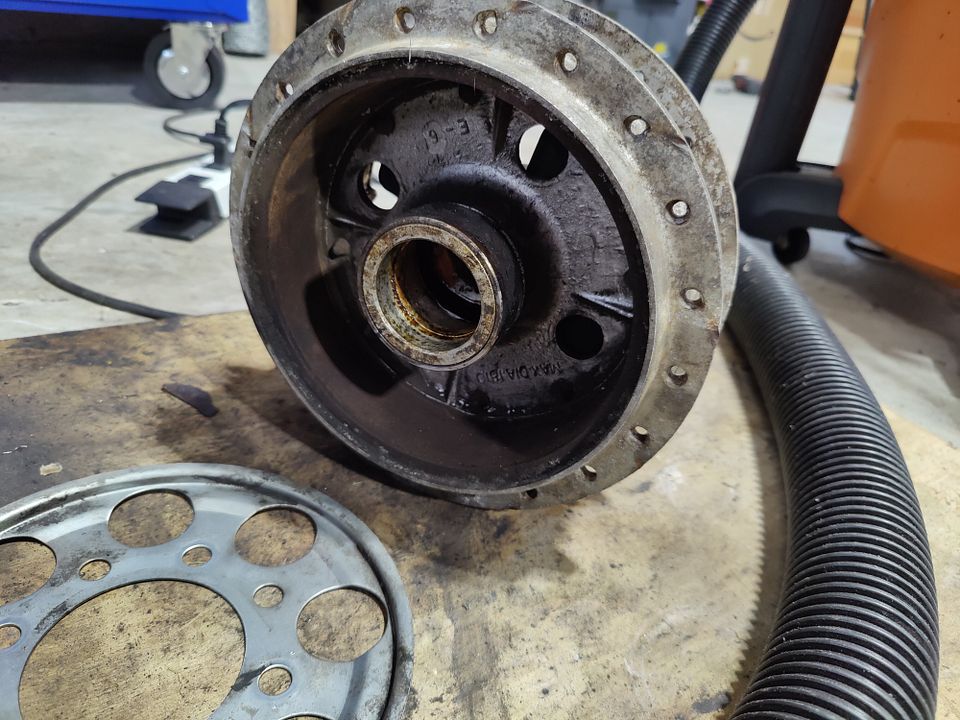

So every single part of the bike is apart finally. Rear hub took a little time.
So I am not very smart on brakes, particularly drum brakes. The hub has an inner layer that the pads press into. What is the material and should I be careful about how I clean it up?

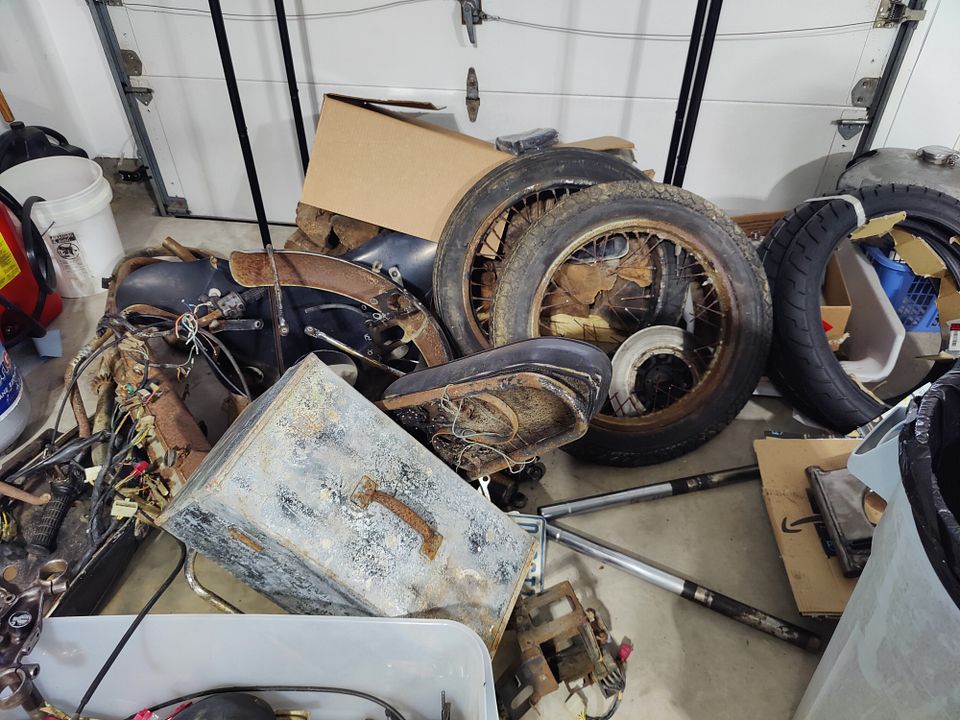

Also for fun, here is my current pile of stuff I need to haul to the dump:
Not everything there is going but most of it. Those wheels are a very sharp rolling tetanus risk.
Looking at this picture reminded me of another question. If the disc brake measures out okay, what are the chances that it can be resurfaced? Just now thinking about this so probably need to do some more searching around here. Its very old but relative to the rest of the bike can possibly be salvaged.

The inside of the drum is a cast iron liner. Don’t be afraid to tackle it with a good, course sand paper, then a finer one. That looks pretty greasy, get it really clean before sanding.
