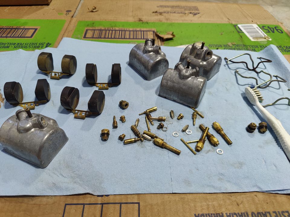

Got the carbs completely disassembled. Outside of playing a game of hide and seek with four springs that shot out of there it went well.
Lots of brown fuel, grit and mush in there. Leave for a wedding Wednesday so probably won't make more progress until next week.

Okay back at it. Finished cleaning up the carb bodies last night. Each still had remanants of wasp nests in them. After several runs through the ultrasonic:

Worked on the float bowls last night. Covered in brown sludge. Got them clean enough that I think I can toss them into the ultrasonic tonight. Those were really gross.

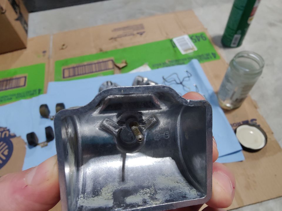

Alright, float bowls, floats and brass small parts are cleaned up. I threw all the brass small parts into a jar wtih some brake clean and just tumbled that around a little to break up the top layers of sludge over everything. Worked well enough. Those got put into the ultra sonic with carb cleaner after.
The float bowls had caked on brown sludge. Scraped off what I could then sprayed brake clean to break up the larger deposits and two runs through the ultrasonic and they look much much better. I think everything probably needs another pass through the ultrasonic though.
The carbs are going well. Still haven't ordered the rebuild kits or anything yet. Want to inspect and see what I actually need. Those floats (not float bowls) looked clean when wet coming out of the ultrasonic but developed that discoloration after they dried. Not sure whats up with that. Any recommendations on if I should replace the floats?

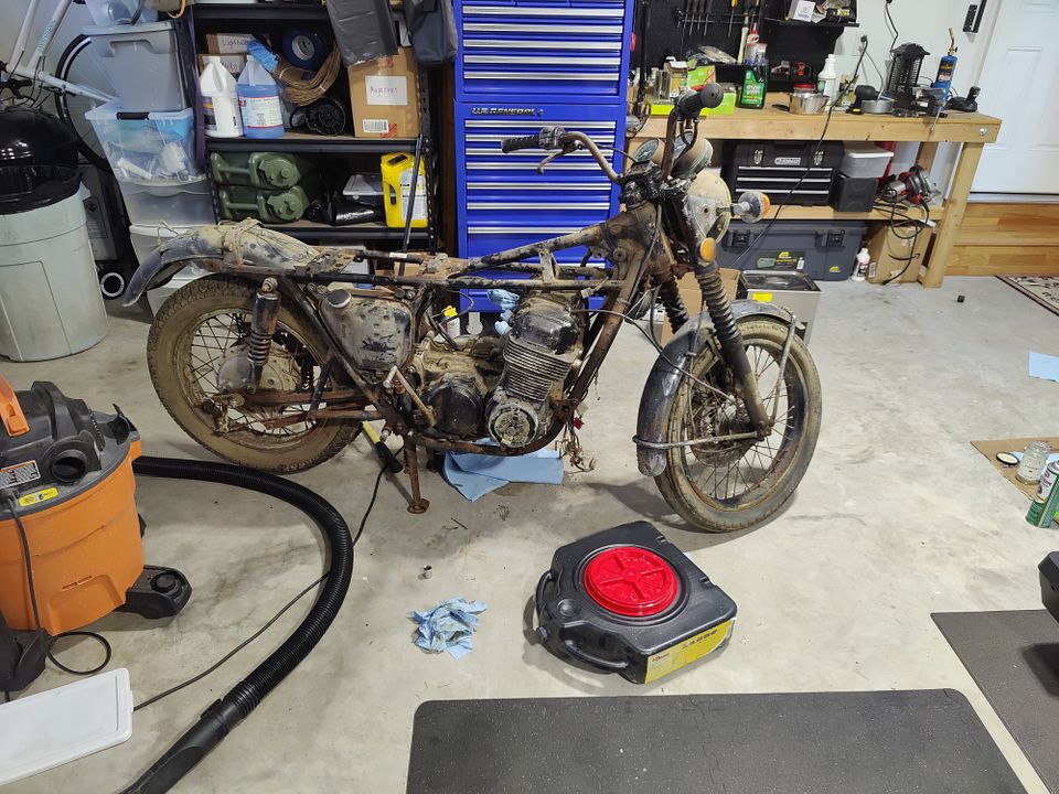

I also stripped a lot more of the bike down and drained the oil. It was VERY dark. But this is the current state of the bike:

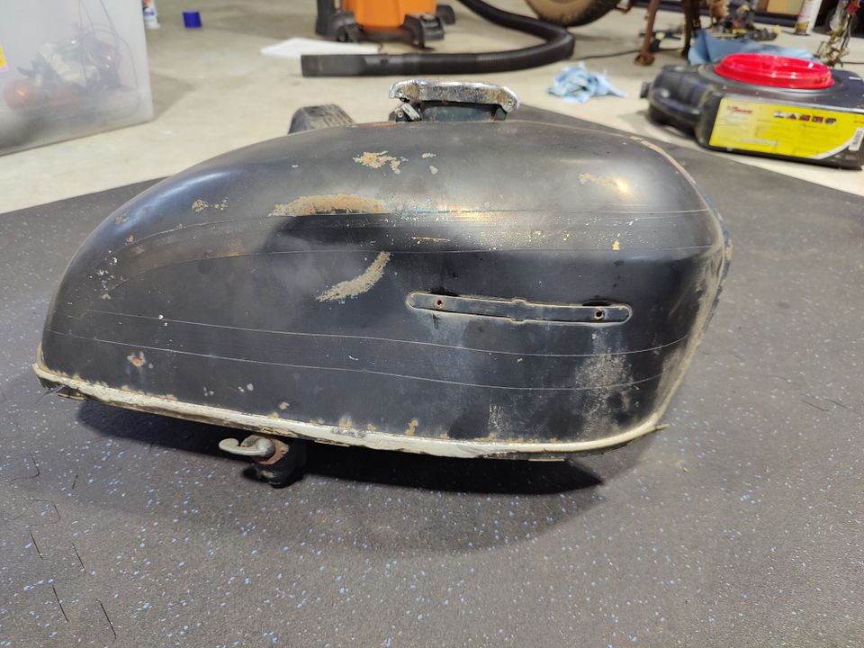

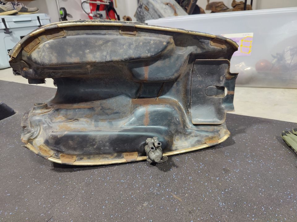

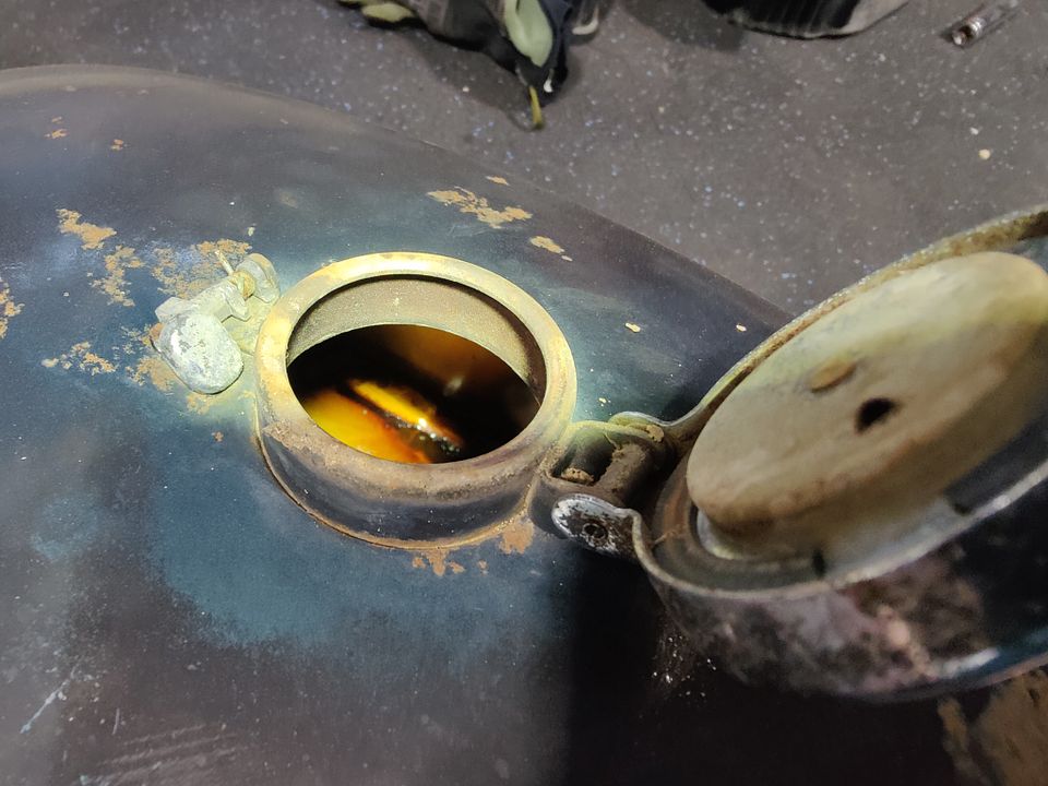

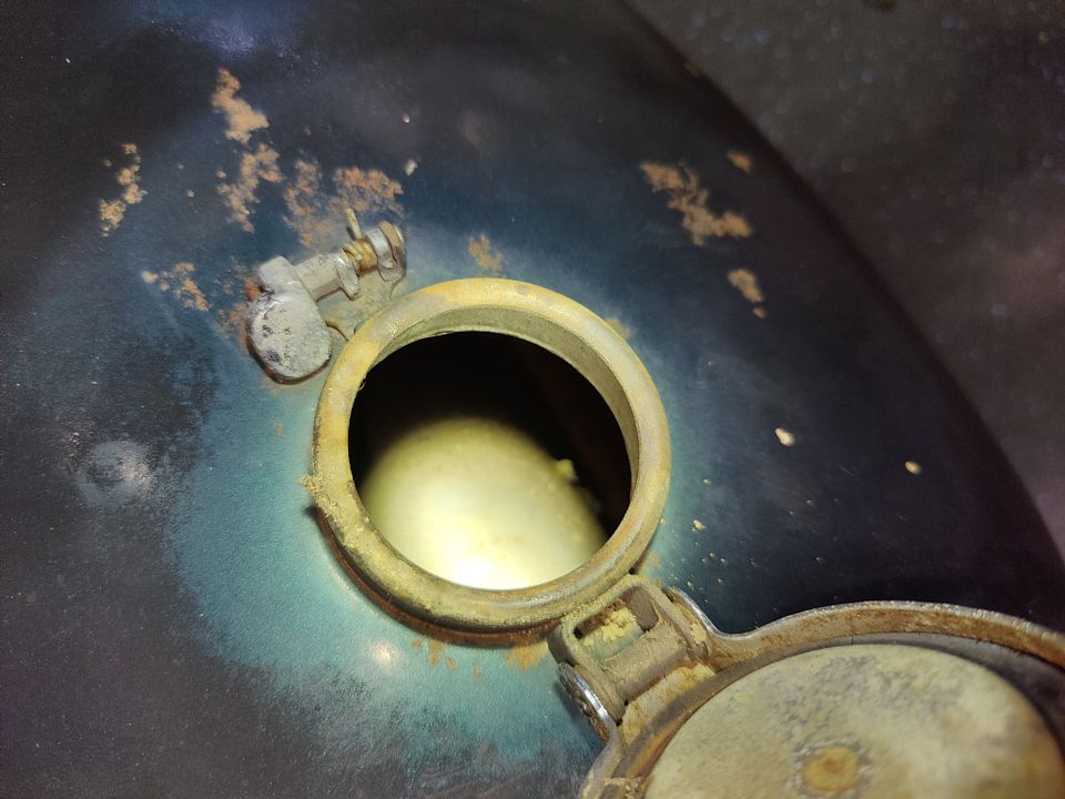

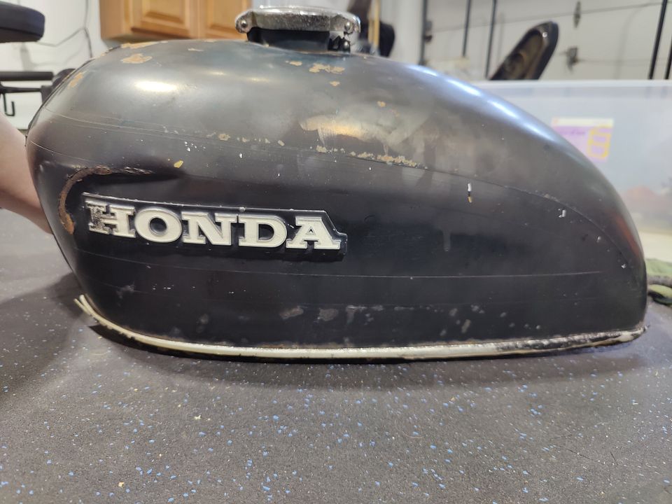

Finally, I need to figure out what I am doing with the tank. It actually doesn't seem to have any internal rust. It does have a bunch of built up gunky fuel?
I need to decide how I am going to deal with the dents. Obviously this isn't a situation where I am going to get it perfect and not use filler. Also light exterior rust. I am tempted to just say screw it and use filler over all the dents. Not sure yet. It does need a new gas gap though it looks like. Any recommendations on what to do with this tank is welcome as well.
Getting close to needing to pull the engine out. I actually pulled a muscle (probably while working on the bike a couple weeks ago) and still recovering from that. So might be awhile before I undertake that. Lots still left to do in the meantime. I am anxious to get the frame cleaned up and see whats under the paint and rust.
