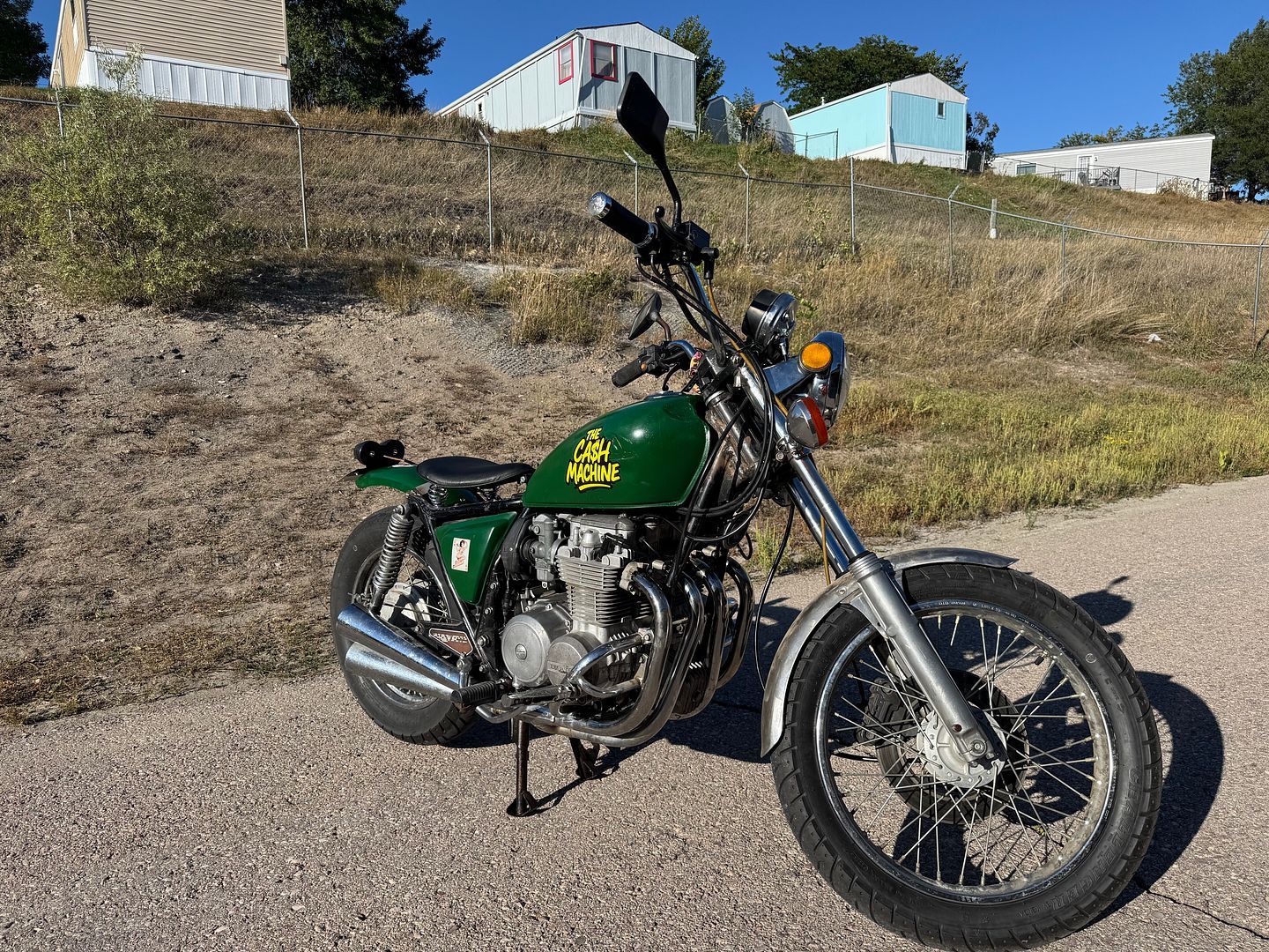

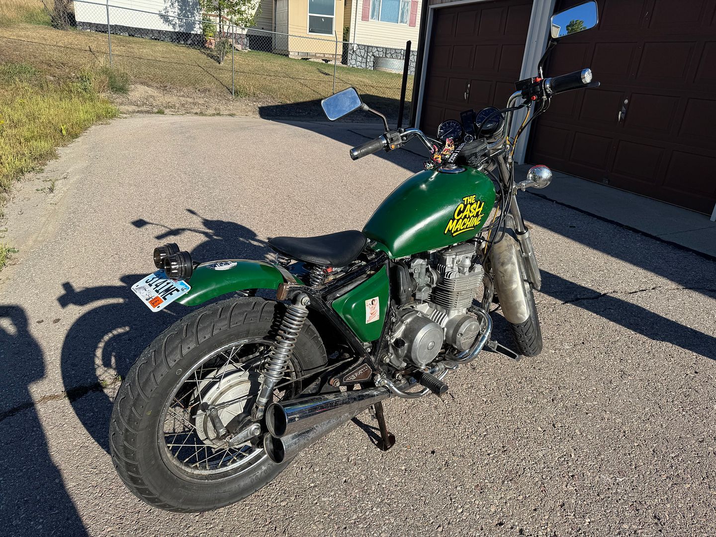

« Reply #553 on: July 07, 2025, 05:58:27 AM »

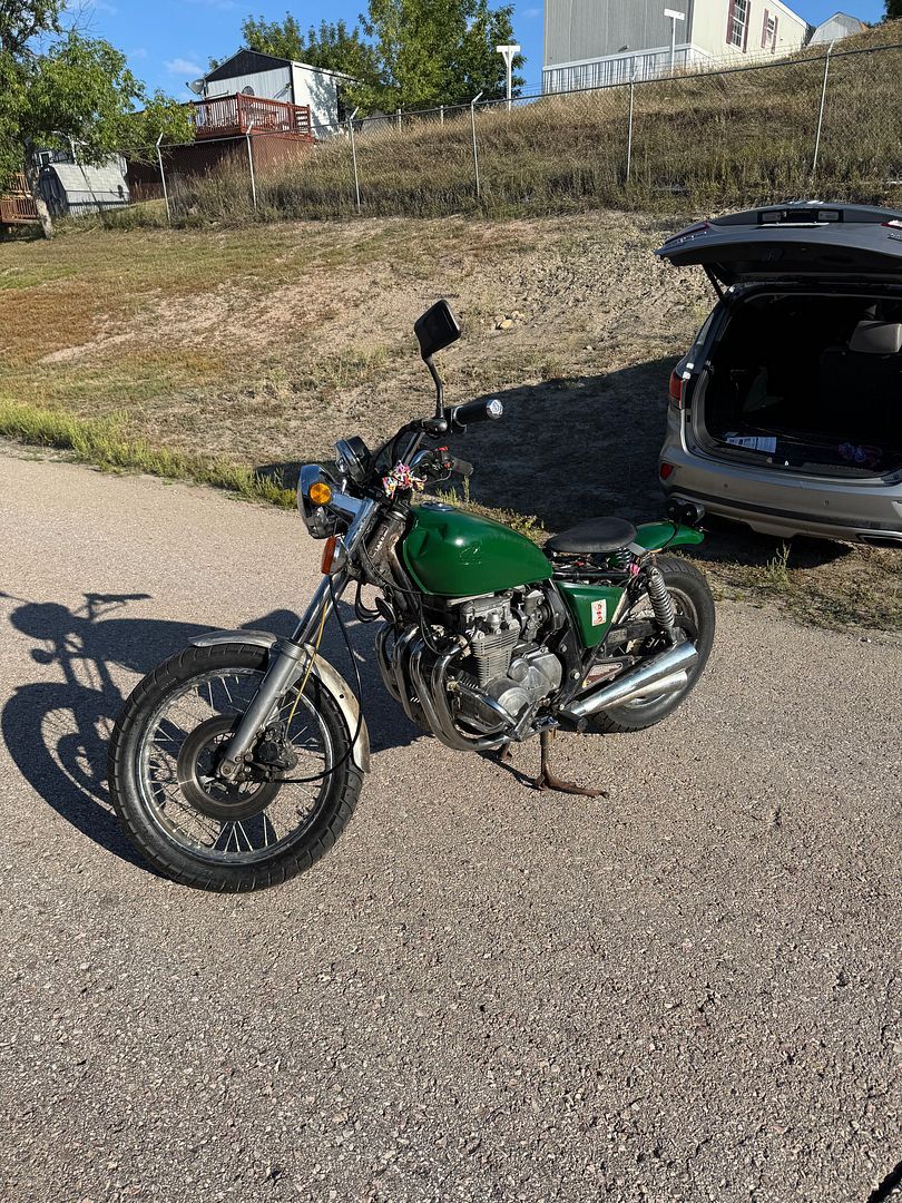

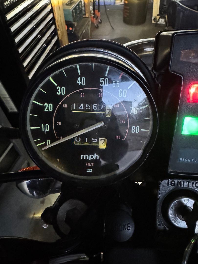

I've been trying to get as many miles as possible on this puppy, my gf thinks I should name it, she recommended something cat related since its black and has multiple lives.
can only upload two at a time.
