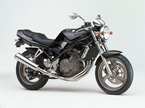

I'm also needing to update my headers as they are rusting through. I have a line on a set of 250 bandit stainless headers and a good mate who will make them look like the original for me.
