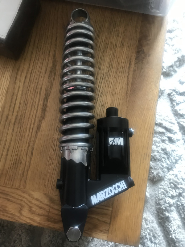

Both my CB750 had Ikons.
My K6 with progressive springs. Very comfortable with good handling.
My K2 had Ikons with linear springs. Too hard, not comfortable or too soft with bad handling.
I replaced them with my old not restored Marzocchi AG Strada (I bought new 1984) last summer. Way better, comfortable and OK handling in higher speeds.
I have a repair kit with seals, bladders etc. One shock does not keep air that long, but still better than the Ikons it had.
Maybe those Ikons have wrong springs. Highest spring setting of 3  caused horrible handling, only 2nd to use with different dampening settings.

Online PeWe
  • Posts: 15,780
Re: I'm looking for a pair of very good aftermarket shocks for a Suzuki
« Reply #9 on: November 18, 2024, 09:51:35 AM »
I ordered my set 2013, Marzocchi UK.
My shocks have 12mm "rods".
Ducati and Laverda forums have also info.
https://www.mdinaitalia.co.uk/50-54.01.1.html
One of all copies of rebuild info. Some sell the free info.
https://ducatimeccanica.com/marzocchi1.html
Marzocchi different models with lenghts and bikes.
I have seen many that sell CB750 DOHC shocks as  for CB750 SOHC
« Last Edit: November 18, 2024, 10:02:16 AM by PeWe »

There was a site in Italy called Suspensionzana that did rebuild kits for the AG Strada shocks, I bought a kit from them in April this year but the site doesn't seem to be working at the moment.
I finally finished rebuilding my really worn out and for some reason really worn body in places Marzocchis in July this year. I decided to go black with chrome look springs instead of how they came, with red bodies and black springs. The bodies were ceramic coated in satin black and the springs in Cermakrome, which is a chrome looking ceramic finish, came out like this. All the alloy pieces like the adjuster and the top eye, damper nut etc were mirror polished to resemble chrome.
The kit contained all the seals, rubber bits etc and they also sold new damper rods as well quite reasonably.
Maybe try and find a worn out set on Ebay and refurbish them if you really want them.
Online PeWe
  • Posts: 15,780
« Reply #12 on: November 20, 2024, 08:46:06 AM »
Which oil did you use?
I read the instruction that the  shock should be tilted a certain angle and refill...
I must do mine soon. I have planned silver metallic instead of the red. Same as I''ll use on my car, Audi A4. Plus 2k clear.
Black springs as is.
I have new decals, top one with pressure and Marzocchi.
I have photo of top decal before power wash when it finally disappeared. Pressure is different depending on shock/bike
« Last Edit: November 20, 2024, 08:47:38 AM by PeWe »
Offline grcamna2
  • Posts: 15,274
« Reply #13 on: November 20, 2024, 10:32:37 AM »
Those Marzocchi's look good.

Offline Oddjob
  • Posts: 625
« Reply #15 on: November 20, 2024, 11:16:14 AM »
I used Motul 5w fork oil, couldn't find any specific 5w shock oil only stuff at 2.5w which I thought too light and the stuff Marzocchi used is no longer available.

Offline Oddjob
  • Posts: 625
« Reply #18 on: November 21, 2024, 04:52:53 AM »
Don't know if it's the same for you guys but my Marzocchi Stradas are odd, they both appear to be from the same side, in that the threaded part for the lower bolt is on the same side, meaning one will have to be bolted from the inside out. Oh and according to Marzocchi the air reservoir fits facing forward not backward but I've always fitted them facing back as I think they look better that way, what do you think?

Online PeWe
  • Posts: 15,780
« Reply #20 on: November 21, 2024, 10:53:29 AM »
My Stradas are 1 left, 1 right.
Bolts from outside. The loose nuts goes in at the inside. Some fiddling to keep nuts in place when I mounted them last summer. First time with 4-4. 4-1 in the 80's,  no pipes  make it tight when get the bolt on and in
I have always had the air reservoir facing backward. Forward looks strange for me.
