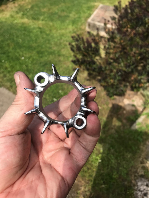

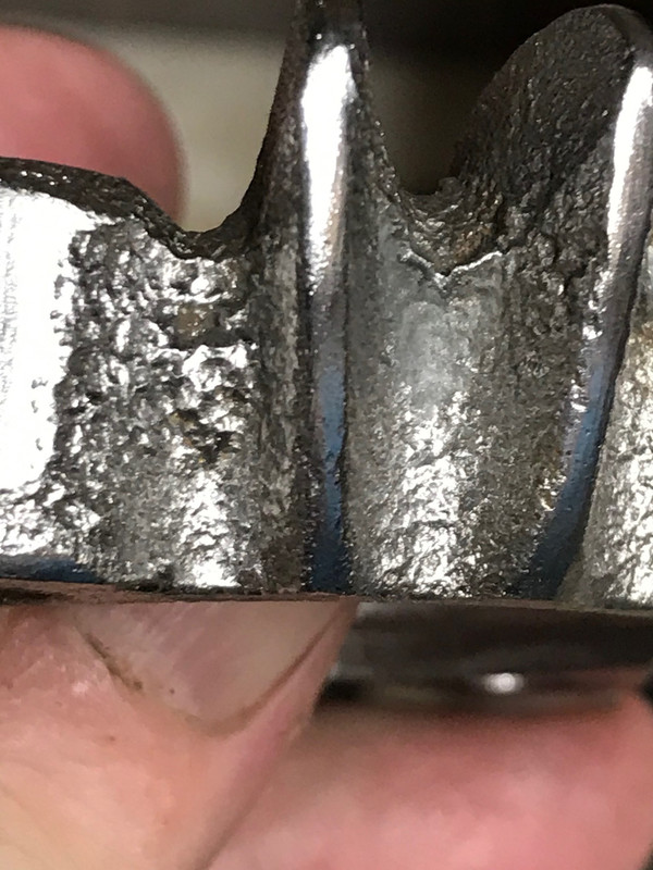

Back on the PC now so this may get a little OTT. Bear with me.

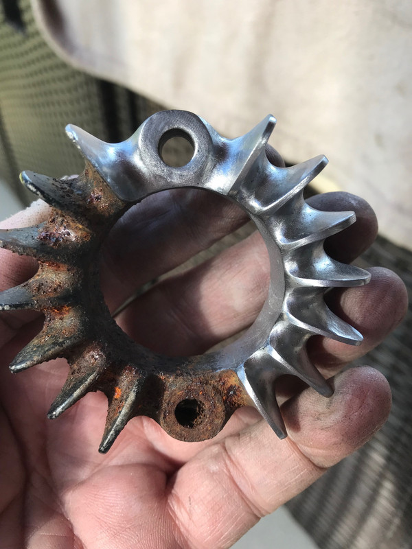

Back in the late 70s, early 80s when I first started to restore these bikes I had some clamps rechromed, they looked ok for a short while but as the chromer explained when I picked them up, inside the fins is the problem, they couldn't get anything to fit down there, so they were just cleaned and chromed. The problem is the casting is extremely rough, there are air bubbles in the castings as well. The edges of the fins and around the bolt holes came out great, they could polish those but the rest was chrome but dull chrome, not dissimilar to the pic from CMS. The clamps started to rust within weeks, right at the base of the fin where it curves round. Within 6 months they looked awful.
So this time I decided to avoid that trap and come up with a different solution. I could have bought new but TBH that just means they last a year or so before going the same way. First thought was cut some of the fins off, so they can access in between the fins, so I had loads of spare clamps so decided to sacrifice one to see how it looked. Came out like this. That's not chromed BTW, that's just me and how I prepare my stuff for chroming, they do it real cheap because I've done all the prep work for them.
Not a fantastic look but it might look ok to you.

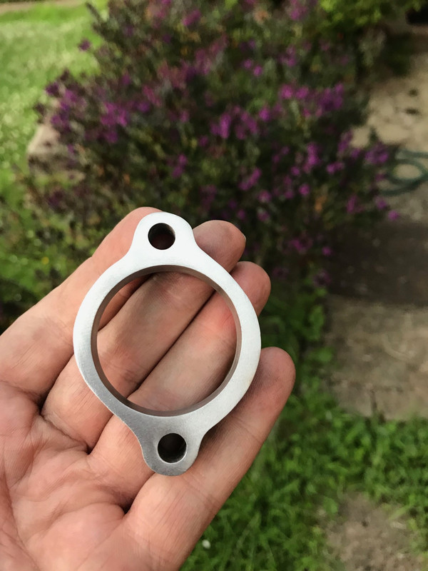

Then I thought, how about no fins, just a plain clamp ring like I have fitted to my CB1300, so off came the rest of the fins and it looked like this.
Simple, easy to clean and should be ideal to chrome. However I was warned that the chrome would blue due to the heat, I can't say that's true or false, I've not tested it yet. I do intend to test it once I get the bike finished next year and have that ring chromed, I'll just throw it on number 4 pipe and see what happens.

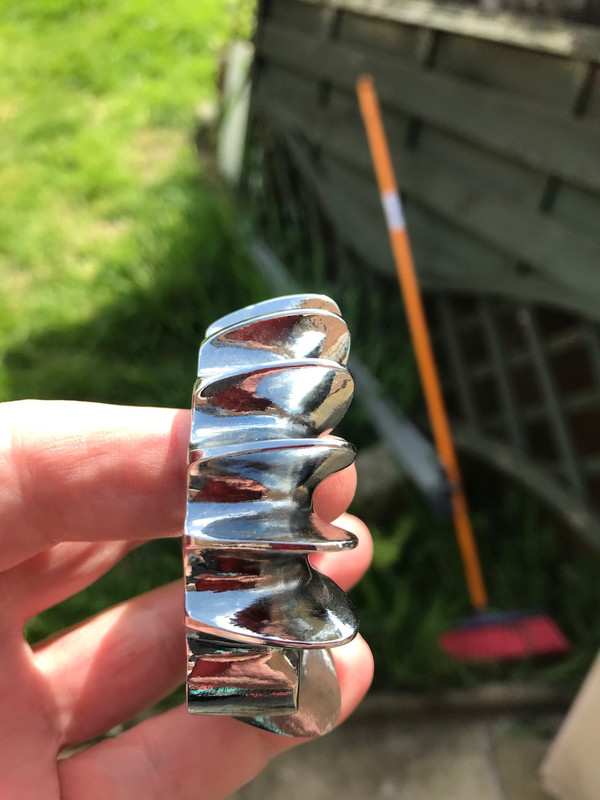

My next thought was to do the job for the chromers for them, polish right down the fins, get them really smooth. I'm really good at polishing but I've got to say that's impossible to do. Firstly the metal looks to have been cast in sand,
it's rougher than sandpaper down there, it would just chew up your polishing mops and cost a fortune. So I decided to grind them smooth, some small grind stones and a Dremel (or similar) this takes hours to do, it's not for those without patience. Each one took me up to 8 hours to do and I was doing 16 of them, 8 for me and 8 for friends. Some took longer, none took shorter.
One half done, the amount of rust is typical for the UK, might be less in hotter climates.

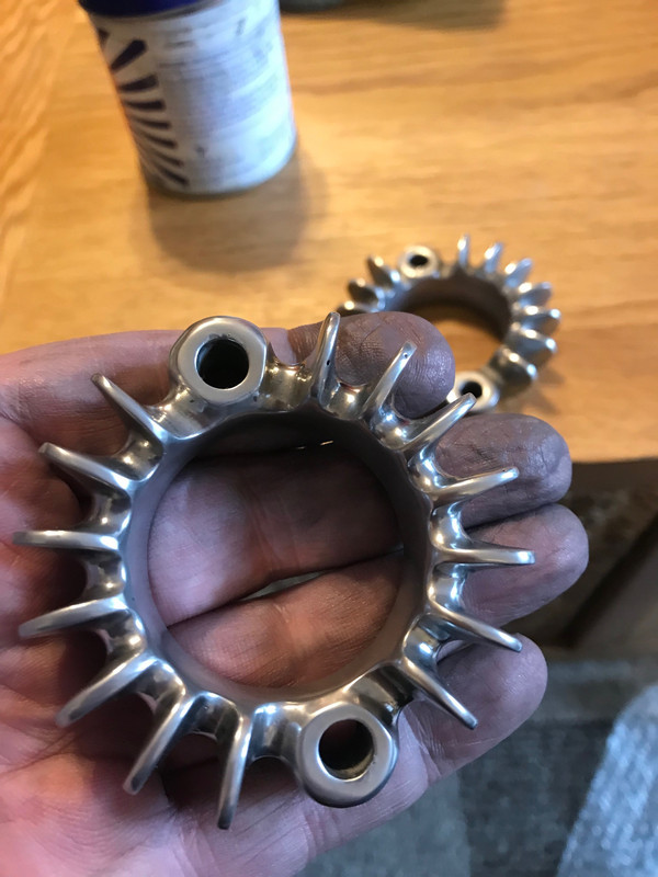

After they were ground smooth I polished them, that wasn't easy either, I needed a really thin mop in order to get to the bottom of the fins. However I got the first 4 done.
So decided to test the theory and took one to my local chromers, he no longer does triple plating, that's copper, then nickel then chrome. It's due to environmental issues and costly equipment needed to comply etc so just nickel then chrome. Cam out like this
Here's where it gets a little OTT, I never stop thinking of ways to improve things and I was getting stuff ceramic coated and one finish was a chrome look. So I thought how about doing 4 in chrome and 4 in ceramic chrome, test them, see what lasts the best. So I took 4 to be ceramic coated and they came out like this. Notice the 2 air bubble holes on the edges of the fins?
Ceramic coating shouldn't rust, shouldn't blue, it should just dull a little with age but a quick going over with some polish and wire wool brings it back up, I've had a set of header pipes done in this finish and it lasted and lasted.
So food for thought, at least you know the pitfalls now.

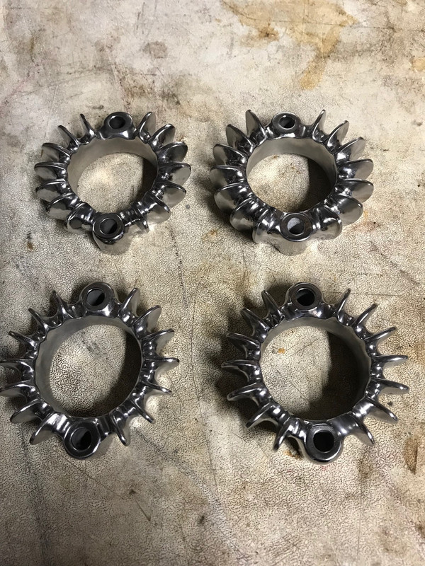

Just brought the flanges up from the dark basement garage I'm forced to work with and sure enough -- you're absolutely right. Sorry for doubting you. I've owned a bunch of these bikes and maybe the chrome was so knackered or flaked off or whatever that I just don't recall seeing anything nice.
The chrome on my 350F flanges has held up pretty well, although I've had to clean off a little rust here and there. I didn't smooth them out at all however.
And really nice work, BTW.
On the 550F they were mostly dirty and covered in burned oil -- leaking tappets at some point had oil running down the front of the engine. I sprayed them with degreaser and rinsed them, and underneath is pretty nice chrome. I'm not going to go all out, but it won't take much to clean them up nicely.
Especially with the handy dandy Q-tip drill bit. Don't laugh, it works pretty well!

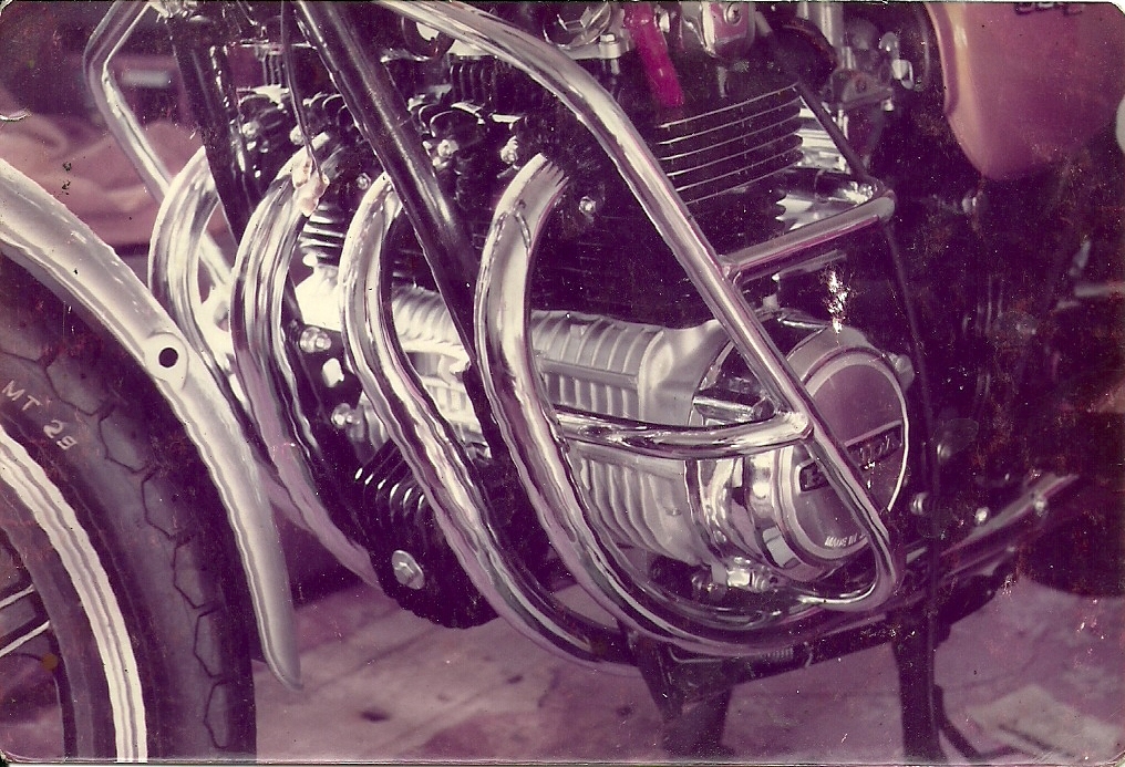

Delta has this weird thing that everything I say he says the opposite, makes him happy so that's no problem. I just tend to ignore him as best I can these days.
He hasn't seen my engine, no one has, it's NOT standard, it's as far from standard as I think you can get, externally that is, internally it's also not standard but I'm not one of those seeking power and speed, if I get some that's great but big bore kits and hot cams are not my thing. For example, my engine is ceramic coated, not painted, not powder coated, it's mainly black and silver, the casings are highly polished, like mirrors TBH, I did do chrome casings on the last restoration but it didn't survive the first winter. So learned my lesson with that one and decided on polished instead.
This is the engine the last time I restored it, it was extremely quiet, tickover at 1000rpm was noiseless, it would go down to 600rpm before it started to make any noise, Delta hates me saying that for some reason so I'll say it again, 600rpm.

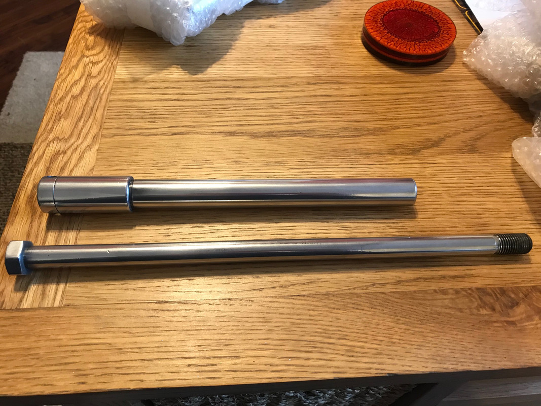

Oh and I forgot to add, to complete the look for the clamps I decided to clean and grind/polish the exhaust collets or whatever you call them, I didn't want nice shiny clamps and horrible rusty collets on a brand new exhaust system, so I spent many hours cleaning up 24 of them, I gave 8 to a good mate for his 550 and kept 16 for myself. Off they went to be ceramic coated as well and came back like this, you get back what you give in, so give them really nicely cleaned, polished etc parts and you get great results.
And if you're looking for ideas. How about doing the wheel spindles or swinging arm spindle.
