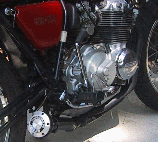

I think the Supertrapp sounds pretty mean.  I also wanted a poor man's Yosh and stumbled across a Kerker header for sale.  It has a pretty long 2" collector so I ditched the megaphone and put a Supertrapp baffle on.  Gives it the racy look, but you can tune in all the backpressure you need.  Performance is the same as the megaphone and it weighs about 15 lbs. less.

I use the super trapp on my GS 1100 E and its a nice baffled sound
just right
at least for that bike it is

How can you compare a SuperTrapp to a Kerker or MAC :o :o :o :o JK
If you have ever heard a Thumper with a Supertrapp, you would definitely say, "Yep, your right. It does sound better".
I've heard them on VF's, XR's, Yamaha XS, and CB F's.

tsflstb, Very nice 400F!!! I see your ignition has been moved to the seat latch lock. How on earth did you manage that???
Glad you like it, even with the second-rate muffler.  ;)
That's not the original seat latch.  All the seat hardware got sawed off.  That would be some trick though huh?  The ignition is a cheap universal type from the auto parts store.  It has the starter wired up to it also.
