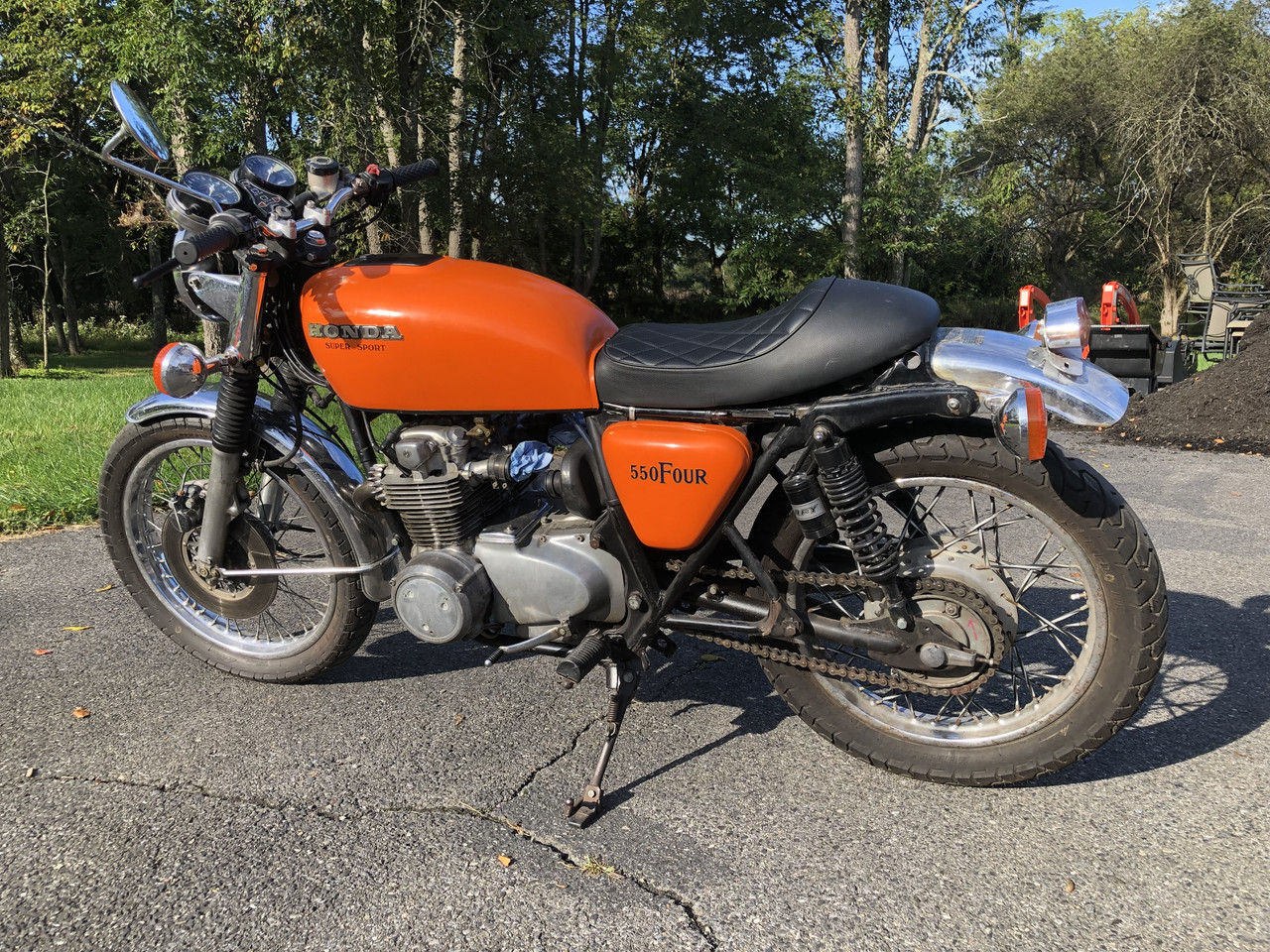

I bought a non-running 1976 CB550F Super Sport 3 years ago and I've been waiting until I retired to do a full restoration on this bike...and I retired on August 1st. Time to get crackin'.
I bought this bike from an 18-year-old after he had owned it for a summer. I know...sounds like a red flag...probably is. The bike wasn't running right for him so he decided to rebuild the carbs...took them a part...and got in over his head. I met both the young man and his father at his father's garage. Dad is in the heavy equipment business. He wasn't happy about his kid getting a motorcycle...and let him get into the project to see how it went. He assured me that the bike is a runner, but it was running too rich. The bike has about 30,000 miles on it.

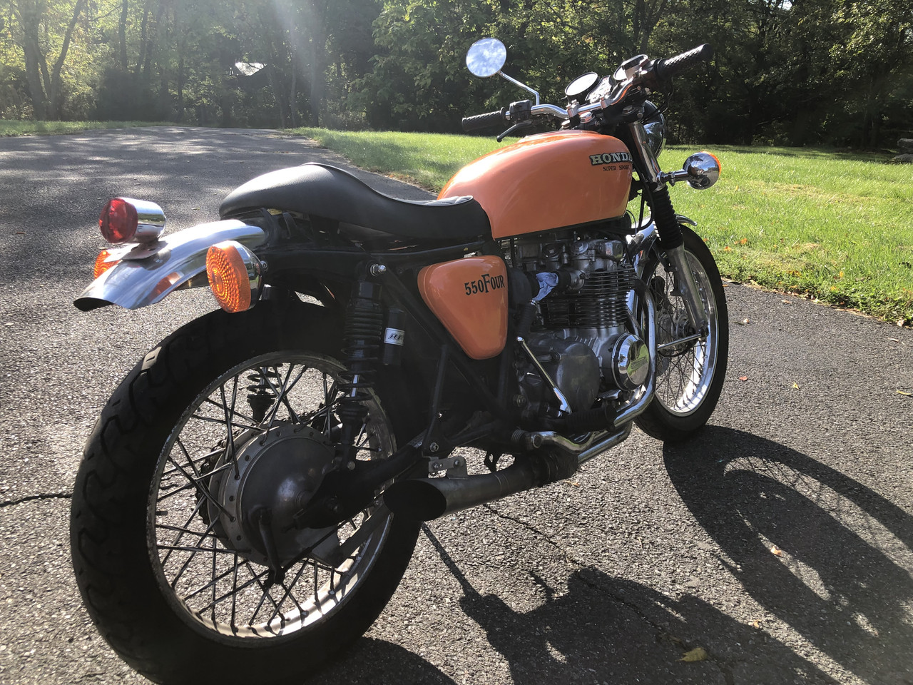

Overall the bike is in fair condition. It looks like it was largely garage kept. There is some corrosion on the fork caps and shock bolts. The tank is in good condition as are the side panels (the left is a little warped on the top edge due to what appears to be a fried circuit in the fuse box). It looks like the owner at that time moved the fried circuit to the spare to the right. I'll investigate.

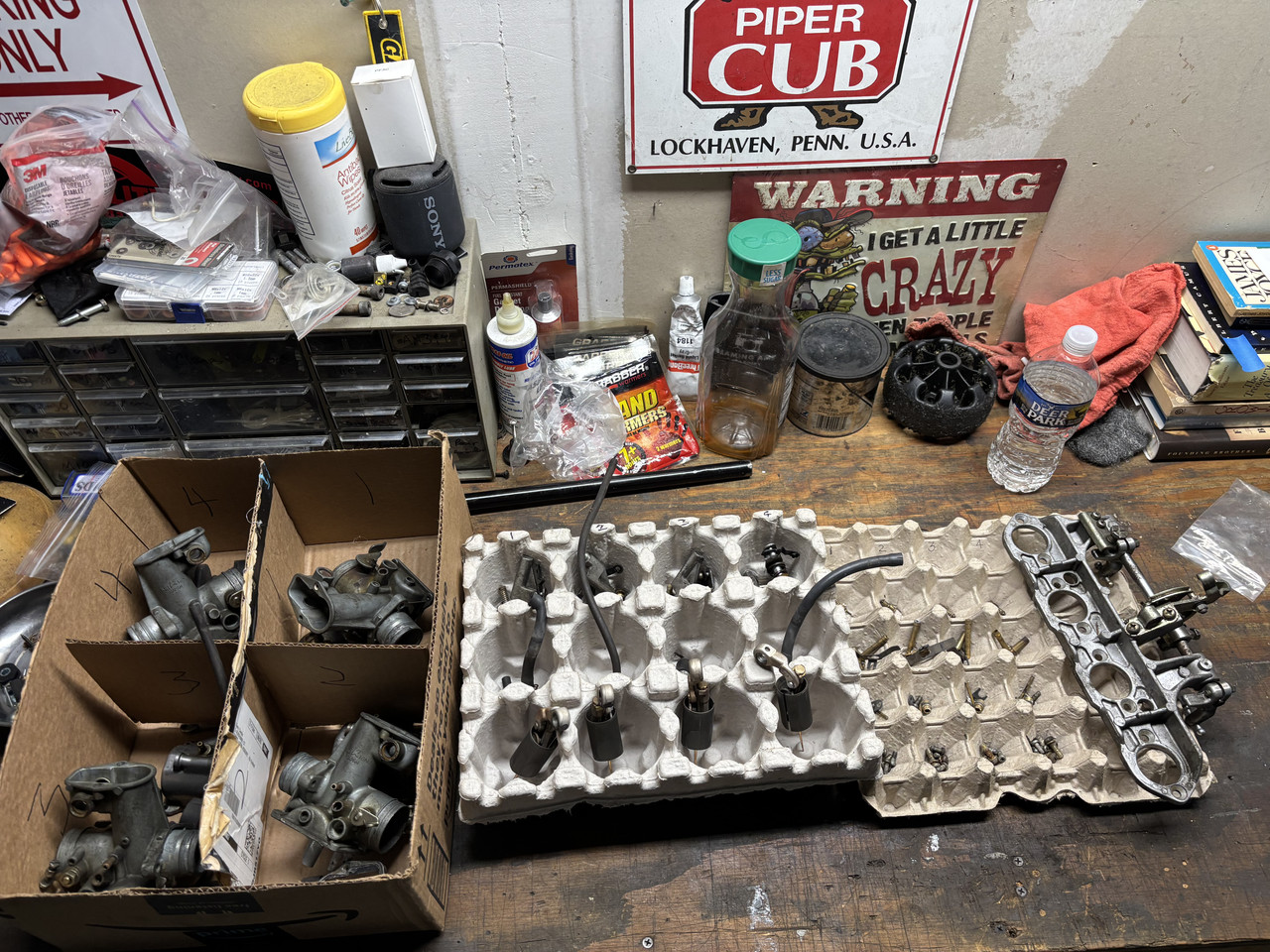

So the other thing I have to do to get this bike started is to rebuild the carbs. When I got the bike I received an assembled carb bank, and a bag of removed parts. The bag of parts looks complete, but I've ordered a carb kit because I have no idea the condition of the brass and all of the rubber is dry (o-rings and boots/isolators). I now have the carbs completely disassembled and ready to go through my Vapor Blaster and Ultrasonic cleaner.

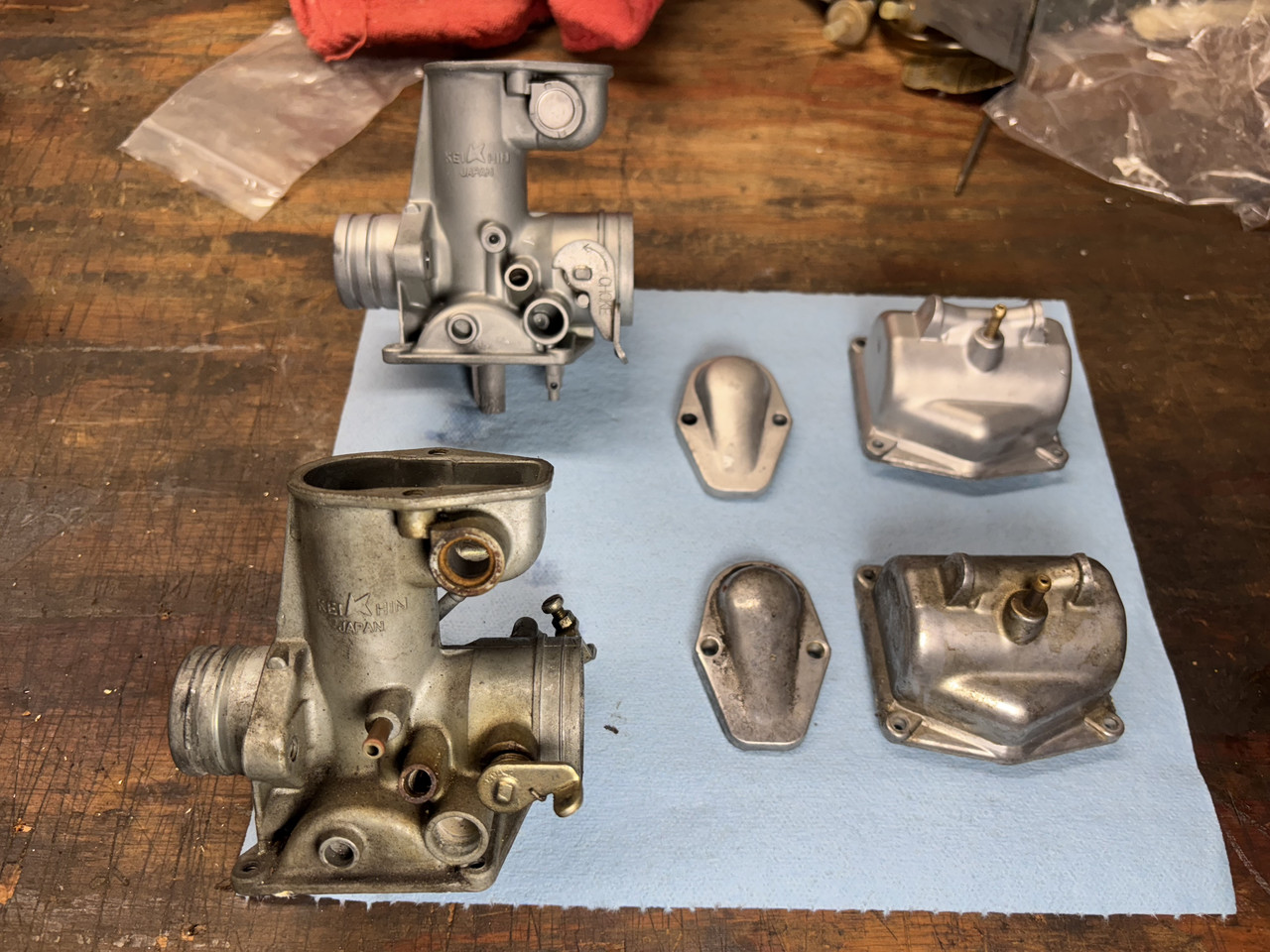

I wouldn't use the Vapor Blaster on the inside of the carb throats or the slides.

Looks like you've got a good solid base to work with. Always curious to me when someone would pair a cafe racer seat and chopped rear fender with the stock (huge) turn signals -- maybe they didn't get far enough along to replace them. I just put a '76 550F1 back into original shape -- I guess I technically could say "nut and bolt restoration" because I replaced a lot of janky hardware and allen head bolts, but it's also just a very clean rider.

   And pulling a rack of carbs on a stock 550f is a immeasurable PIA. Right about the third time I'd done it my first thought was, "I'm not doing this again if I don't have to."
But it is also possible to (very carefully) switch out internals like jets and float valve with the carbs on (although I broke a float tower doing it months ago...). I switched out allen bolts for the stock JIS for the float bowl screws, only thing I kept allen bolts on. I had taken the carbs off and on a few times after replacing the pods with the stock airbox and while tinkering to get it running right at altitude -- I'm at about 7500 feet elevation.
The stator cover plate is still available -- I think I got mine from CMSNL.
I've got a spare set of 069A carbs for the 550F with original brass. I bought a spare set, and an extra carb, and then found another super clean set at Bob's Salvage in PHX. I'm selling the rack for what I paid for it: $125 + shipping, and it's all there, just needs to be cleaned. HMU if you're interested, and best of luck.

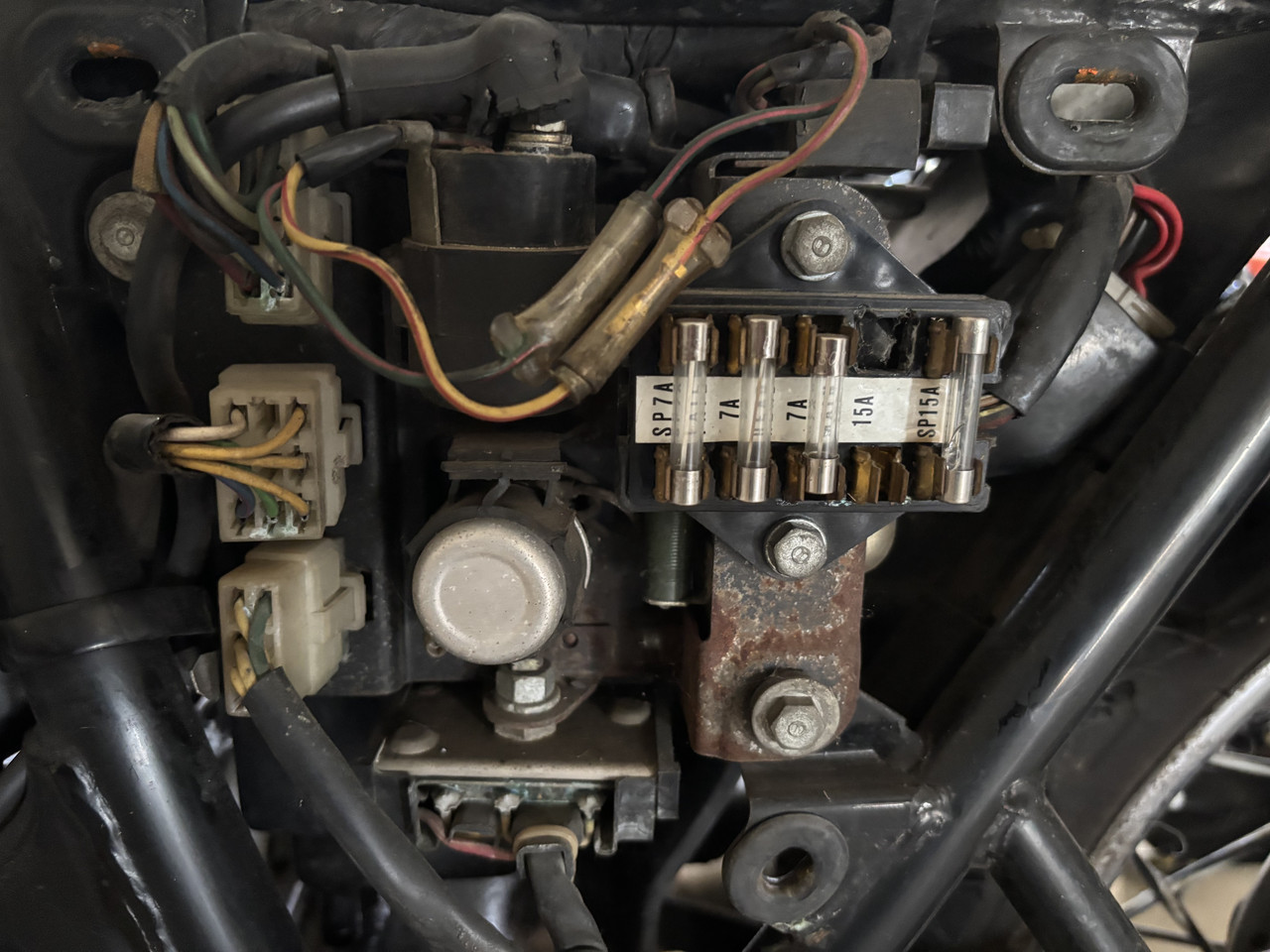

PS. Hondaman sells a nice plug & play fuse block...
https://sohc4shop.com/blade-fuse-holder

Scottly - I have a lot of experience with Vapor Blasting. I use a 170-325 grit on carbs. I hold the nozzle (@55psi) about 1/2-inch to 3/4-inch for polishing, and 1 to 2 inches for cleaning. The interior of carbs get cleaned only. After they go through the VB, they get rinsed and then go into the ultrasonic for 20 minutes at 122F. Here is #1 done:
Stev-o - thanks for the Hondaman link, I will be using that updated fusebox. Let me know about the muffler!
