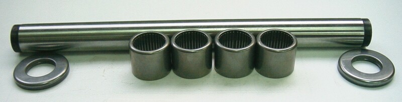

 Or just use a needle bearing kit. I ran one for years and never had any problems
Both my CB750's have needle bearing kits.
My K6 got one 1980. Stock was crap.
No issues, installed with grease with no refill. Ca 65.000 km, most of them with 836 closer to 80whp. Long tours thru Europe with high load. 2 persons and luggage.
Bike got a restored K2 swingarm to 2014 with new needle bearing kit. Old arm had broken brackets for chain guard.
Now after over 55.000km,  25.000km 80-90 whp,  30.000km +100whp mostly 105, top 107.5 whp. So the swingarm has got some to hold. Still ok handling.
I have thoughts about taking out the bolt and fill bearings with new grease when changing the tire next time.
The shocks lowers need to come off from swingarm too.
Maybe worth it so I know.
« Last Edit: April 01, 2025, 09:49:44 AM by PeWe »

Do you remember what the brand of those roller bearings was, PeWe? I tried 2 different sets, but both were as loose as worn-out bushings after installation.
By that time I had installed and removed 2 sets of 'bad' bronze ones from eBay (one set had too large OD, crumpled on the way in, the other set had the flanges, which were too thick and made the collar and bike frame span too short), then 2 different sets of the roller bearings (one VERY loose, the other just loose), then I bought a lathe and made my own. (I worked in a machine shop then, too, had excellent assistance!)

I used a Tour Master brand needle bearing swingarm kit on the 74' CB 550 K0. It installed easily and works great, it wasn't loose or anything like that.

I have the Tourmaster kit as well.  Purchased NOS, no idea if it is still available.  Have been saving it for a build that needs it that will also be a keeper.  Also have Dunstall swingarm on one bike that uses roller bearings.  I did record the Timken part number so  replacements could be sourced at some time in the future.

https://www.z1enterprises.com/swingarm-bearing-kit-cb500-cb550-cb750.html

SCI has a good price on the swingarm roller bearing kit.
https://siriusconinc.com/products/detail/1179

I have installed that kit....it went in well all times.

The K2 swingarm my K6 got was bought on Ebay. Restored, powder coated and needle bearings fitted.
My K2 got a set from AC-Motorradteile on eBay Germany. They do not have that today.
I have a new set I ordered from CCC. Planned to be used in a build.

I think 4 bearings would better support the swing arm than two and having a wide bearing width like the stock bushing ideal. I also have no issue with bushings. I ride bikes with both (road and dirt) and replace needle bearings more often (dirt bike) due to water contamination. Needle bearings will fail sooner than bushings under that condition. A modern bike with needle bearings employs rubber seals, something to consider when missing in the design.

Both needle roller and taper roller bearings work fantastically when the shsft or bearining is rotating like in a wheel but do not do as well when only moving backwards and forwards around a centre point, in this condition they are prone to brinelling(hardness failing) and indenting the races or shaft. Load capacity may be stightly higher but life isnt

I dropped those thoughts today when I changed rear tire. It took some time and efforts. Swingarm has no play sideways.
I thought if I should remove bolt and inner shaft, needles can fall out and suddenly lots of more work....
I have a K6 swing arm, new powder paint without bearings. I'll install a new needle bearing kit for the day my K6 can get a K6 swingarm. Probably new shock bushings too.
I'll try a Tourmax kit in it.
I checked my bearing kit I ordered from Classic Cycle City eBay Germany 2 years ago. To be used in my too slow CB750 K2 build.

How to modify these roller swingarm kits to be greasable from the swingarm pivot bolt size zerks? The sleeve goes over the original pivot bolt but has no holes for grease to flow from the inner bolt through the bearings on the outside. I was thinking mine is due for fresh grease since installed in 2013, but maybe I should drill a hole toward each side of the sleeve inside of the bearing. Idea being grease goes in the bolt, through the sleeve, then back out to the side through the bearing. Thoughts?
Offline bryanj
  • Posts: 15,014
  • CB500 Number 1000036
Re: The never ending CB750 visual inspection - swingarm bushings
« Reply #48 on: September 09, 2025, 02:08:15 AM »
Thats how it worked on the original setup but you might find the pin to hard to drill.
Just for info every time i stripped a swing arm for play i found the collar more worn than the bushes

That Honda bushing numbers are the same (52108-300-300) for the 750, 500, 550 350 until you get into later 750's 550's and the 400f which are flanged (52108-457-300). That indicates OD and ID are the same....flange is the only difference. Like everything else with an interference fit it is a good idea to measure OD and ID. If OD is slightly too big put it in a lathe and use some paper on it. Check the ID of the bushing/ OD of the pivot too...I've had to hone some bushing ID's. Or just use a needle bearing kit. I ran one for years and never had any problems
I have a needle bearing kit in my CB750K2 that went in there in 1993 or so, granted it sat idle for a couple decades in between then and now. Still seems OK.
