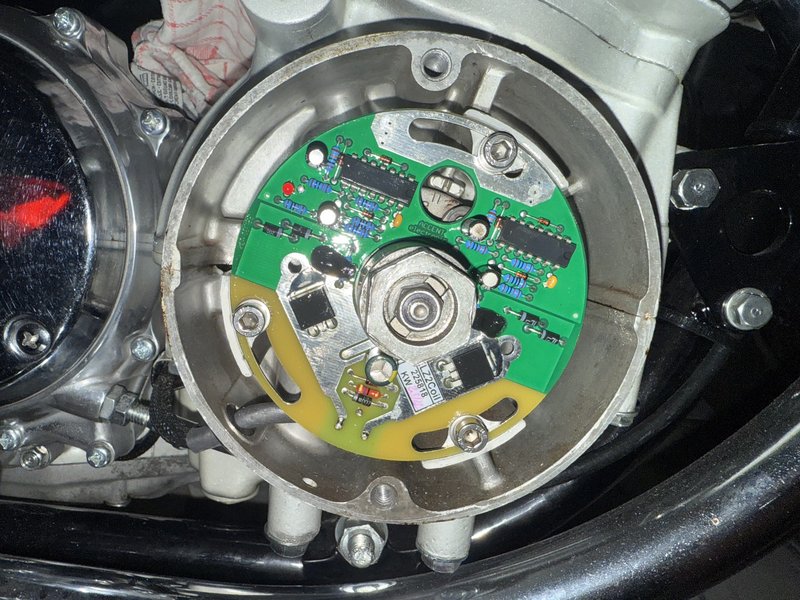

Furthermore the bike ran before carb overhaul so I’m thinking I nicked a cable or connector somewhere but based on the above, all seems fine.
Only thing that could have spontaneously died, is the accent ignition system. So I’ll see how to test that.

Not yet, i'm suspecting faulty connection between coil and ignition. Hope to find some time this weekend to look at it again.
