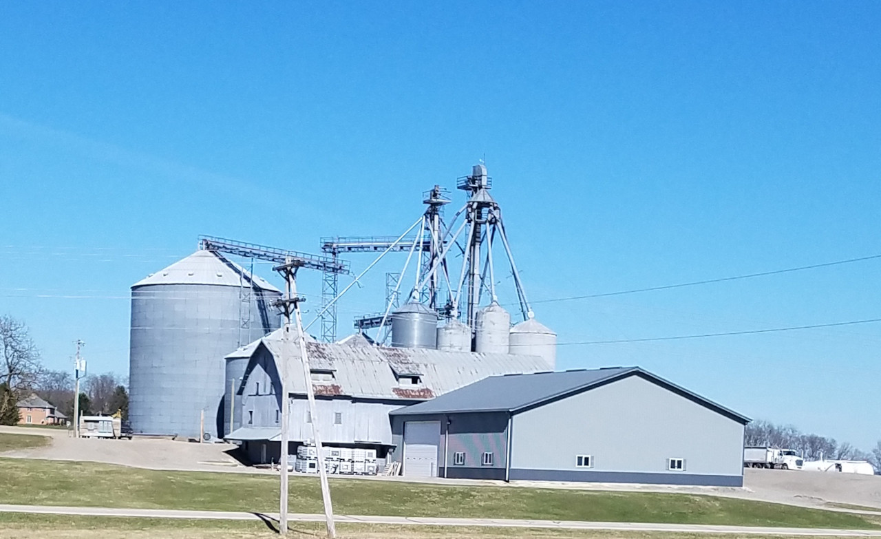

03/09/2026 Ride #9, another 100+ mile day! Well after spending the best part of the weekend on the tender, the Yamaha Turbo fired right up.
I gassed up Blue and took enough tools to remove the required body-work on the Yamaha if need be. Lots of blue sky and sun shine, temps in the mid 50's on the way out.
Took the Yamaha off the tender and thought I'd give it a go before removing anything to access the battery and I'm glad I did. No hesitation at all, she pop right off. Left it to run as I put Blue in the shed in her place and got things buttoned up.
Was a bit over 20 miles out on Blue and then a leisurely 90+ miles on the Turbo coming home. After about 60 miles the computer on the Yamaha decided that the battery was fine and stopped warning me that we had a problem. For me the only thing wrong with the 1982 XJ650LJ Seca Turbo is the gadgets they put on the bike. It checks the headlight, taillight, battery, and a couple other things and if it thinks there's a problem, it flashes a red warning light. You can over-ride the warning, but every time you you have to stop at an intersection it starts in again. The little probe that test the battery electrolyte is unobtanium, but I might be able to come up with some simple electric circuitry to make it happy feeding it from the positive side of the battery.
I wanted badly to get a photo of this massive field of winter wheat that was coming up, just to show Jim. It was emerald green and lush, but with all the recent rain there wasn't any place to pull over and get a photo. It would have looked like I was in Ireland if I had got the photo.  ;)
