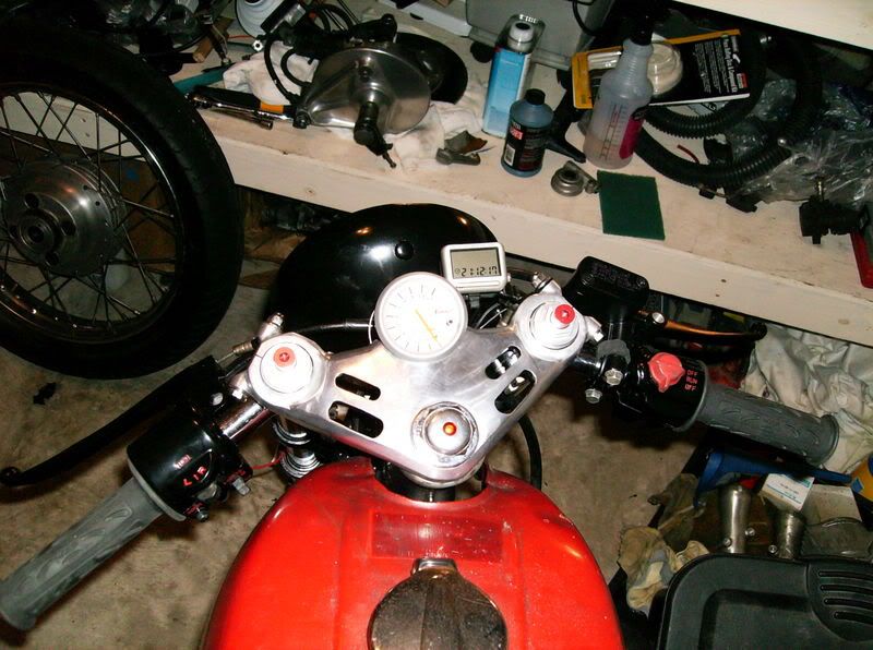

-Smoothed and polished top clamp and modified to fit the small electronic tach.

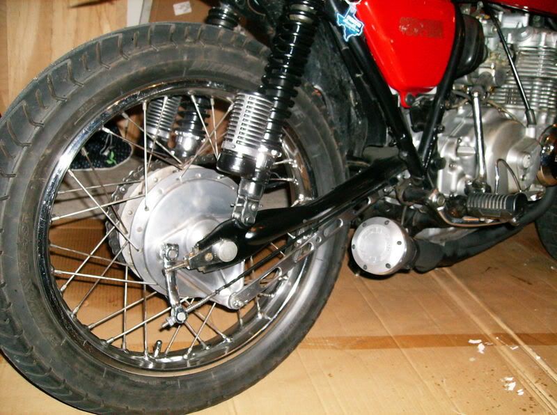

-Lace alloy rims to stock hubs.  A custom Buchanan spoke kit is on the way...I've got my fingers crossed on this one because I'm not sure what hub the front rim is drilled for.  It was too cheap to pass up though.  Judging by it's size, I'm assuming it's for the rear of a 125cc dirt bike with a disk hub and that I can make it work.  The rear is a shouldered Akront that was drilled for a drum hub very similar to mine.  It was pretty nasty looking, but I re-finished it to look good from 5 feet away.  I may regret starting this later, but I really wanted to lighten up the wheels.

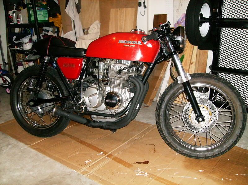

I cut short some of the work and put the bike back on the road last last week.  With a hurricane in the gulf, I figured I might need some cheap transportation when gas went up.  Well, it hit our neighbors south of the border...sorry guys.

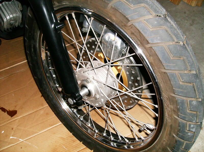

The front rim was a bust.  Spoke angle was all wrong.  Crap.
I'm going to bite the bullet and have Buchanans drill one custom ($$$) for the front.  Still debating whether to go with black or polished rims.  This is your cue to look at the for sale section.  I'm selling off some parts to fund that little endeavor.
Other than that...I've got the new tach working, took a couple pounds off the front with the drilled rotor, spacer to remove the speedo drive (from TTR400), and phenolic brake piston.  I also put on a low-profile master cylinder from Mike's XS.  I'm still bedding the system in, but it bites pretty hard.
Also got one of those pimpin' rear brake stays from TTR400.  I feel like a rock star now.
Next I'm going to get after that spare gas tank with the POR-15 kit and either black or silver paint.  Thanks for listening.

wow that is one sexy machine, is that the original top triple tree that you just ground down? please please post more pics. I need inspiration, my 400f is in my garage with its guts wide open
Triple tree is stock with a few hours of grinding and filing on it.  Wish I had a milling machine at my disposal, but my set of Harbor Freight files work OK.

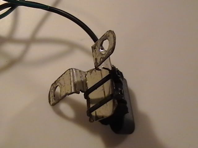

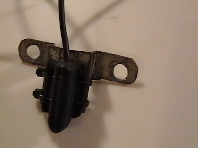

Let's here a litle more detail on how you installed the speedometer.  You've got a digital gauge and some kind of sensor somewhere?
It's a standard bicycle speedometer (I think the brand is Panoram V9).  The sensor is mounted on the left fork where the brake caliper arm bolts up (pics of the crude bracket I made below).  The wire is wrapped around my brake line up to the display.  There's a small magnet you clamp to a spoke, enter the size of the wheel in the display, and you're done.  I think it maxes out at 99 mph, so no "ton up" patch for me.
