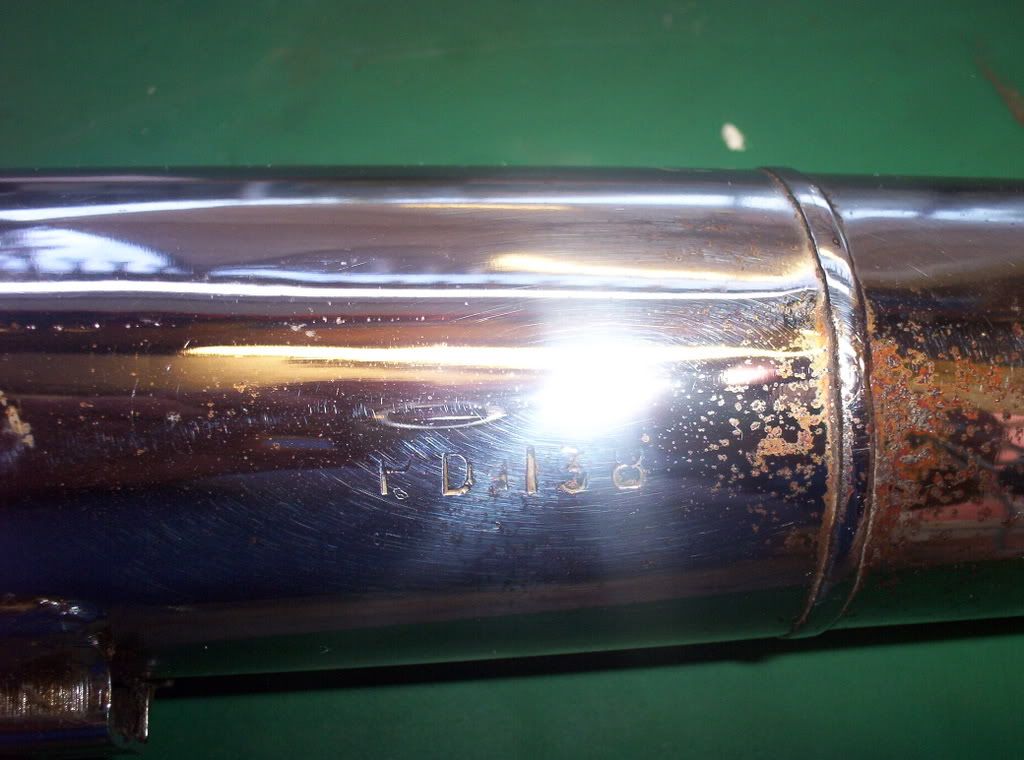

Thanks for the reply.  Any chance you could get the serial number off the exhaust?  Mine is PD1138, just curious if ours match or not.  Could you perhaps measure the diameter of the can where the pipe meets the header as well?

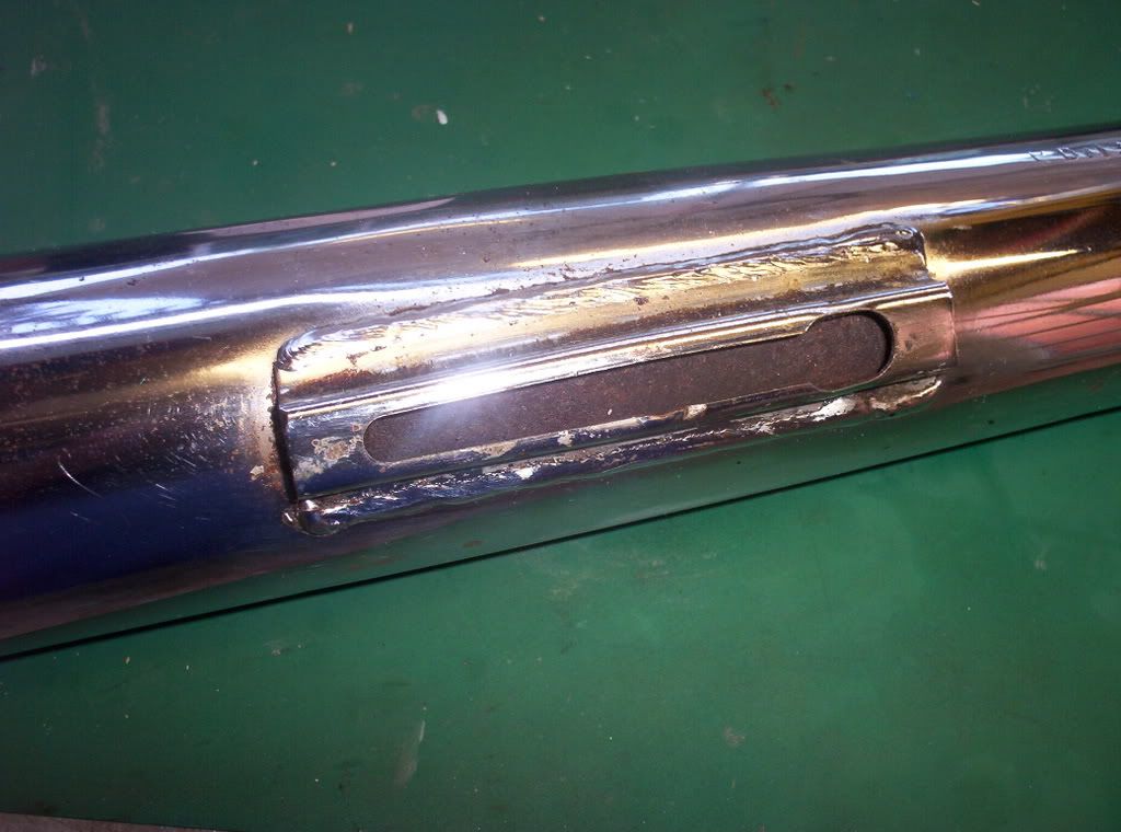

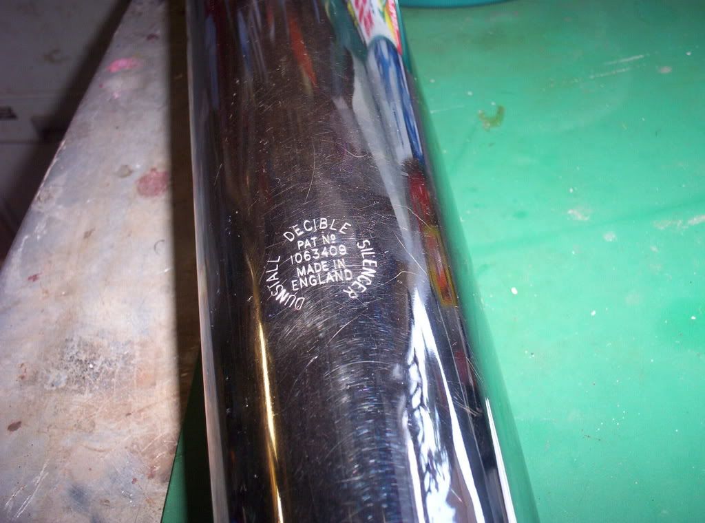

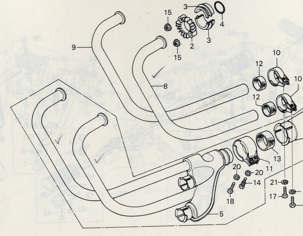

Well the numbers on the Dunstall match, just the header, I've attached a diagram of the F1 header and pics of my F1 Dunstall.

Yup, found my issue.  The Dunstall can is or a '75-'76 750F header, the header is for a '77-'78 750F.  The diameters of the pipes don't match up.  So, anyone have a solid header for a '75-'76 750F that they would like to get rid of?
