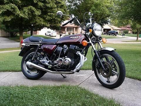

These are some current pics---I am far from done, but I put a little love in here and there when time and what little money allows.
I was given this thing last year because the guy who took it on, his son went off to serve in the Army. It was meant to be a father/son project and well that went out the window when the boy left. The PO did have the carbs professionally cleaned, but the peoples didn’t put the needle on the third groove, so he could never get the bike to get off of idle. Originally he wanted to charge me the 300 dollars which is what it cost him to have the rack of carbs cleaned, this was in 04 and by the time 05 rolled around, he purchased a new Road King Classic and said, look I know you have a passion for bringing things back into working condition, so tell ya what, you come pick her up and she’s yours for free. Bingo--- I can’t pass up free, plus I have wanted a bike for a long time. So, needless to say, I brought this old girl home in the back of my Dad’s pick up and started to work on her. With me being foreign to bikes, I decided to keep things stock so that I would have an easier time tuning the bike.
I installed new NOS Honda coils and boots,
NGK plugs
Honda P&C plate
NOS rear master cyl and rebuilt the caliper
Oil filter(s)
New chain stayed with 630 o-ring and new sprockets
Set the valves clearances per the book until I read Honda man’s explanation of the F head and went back and re adjusted the ex valves.
Installed all new wheel bearings All Balls--- I added my own mobil one synthetic grease and reinstalled the dust shields
New tires stock size, new tubes, mounted myself and took them to get balanced--- again I would have went wider in the rear but am new to bikes
Used right rear signal housing and lens
Went halves on a synch kit with my pop--- me bringing this bike back to life inspired him to get his 82 Suzi GS1100GLZ over to my house so I could bring it back to life.
In between I kept polishing here and there, painted header and muffler tip, polished a bunch of screws, polished the foot peg aluminum brackets and yet I still have a bunch more to go.
New blinker flasher
Cut a tad off of the rear springs so that my feet would be close to flat on the ground and yet so the springs would not be loose if the shock was fully extended.
Adjusted voltage regulator
I have put about 700 miles on her since I got her and she runs great. She does smoke like a steam engine for the first 5 mins but once it is warmed up it is fine. Darn F head. I plan to pull the engine on it this winter and remove the head and repair what needs repairing. I also plan to look into the carbs, I am not sure if they have been properly jetted but the bike screams as it is so I don’t feel like messing with it. On another note, she is at about 16500 miles, so I don’t think I will get into the bottom end just yet. I do plan to install an oil pressure gauge to monitor how the clearances are stacking up on the big end of things. Maybe I will throw a cam chain and inspect the adj while I am at it.
I'd like to know who the manufacturer of the exhaust system is on my bike. I also would like to know what those semi-ape hanger bars came off of.
Anyone has any insight, please let me know. I am planning on down downsizing the bars to stockers, but I do admit the current set up is comfortable.
I asked this on the other post, so you read it twice bear with me. Is it true that Honda no longer makes side covers? I saw some posts regarding the issue and some Ebay ones to go with, but was curious if any F guys had any personal experience.
I really wouldnt mind having her repainted--- I would like to reinstall the stripe--so if you know of a good local for factory colored paint and decals, please let me know.
Hope you all have enjoyed how it came to be...Good luck and safe riding to you all.

you did one hell of a job on her,congrats

that is a SWEET exhaust. What is it and where did you grab it?

I have no idea who makes it, it came with the bike. I have yet to find one like it. I was wondering if anyone on here might know of where it originated.

  Looks good and you can't beat the price, but if it was mine the ape hangers would have to go. Dannie

Nice job polishing that turd! ;D

Hi your bike looks excellent  8), you can get side panels from Dave Silvers here in the uk & tank decals etc from Reproduction Decals ;),  cheers mick.

Nice job with the bike. The apehangers should be the first thing to go.

Looks great. I'm not sure what the market will bring you for it. Follow other sales on EBay as a guide. Possibly $2K+. One of the guys is trying to get a group buy together for F side covers from LPM. Do a search for it and maybe we can get a better price. Only downside is I'm sure they would need to be painted.
