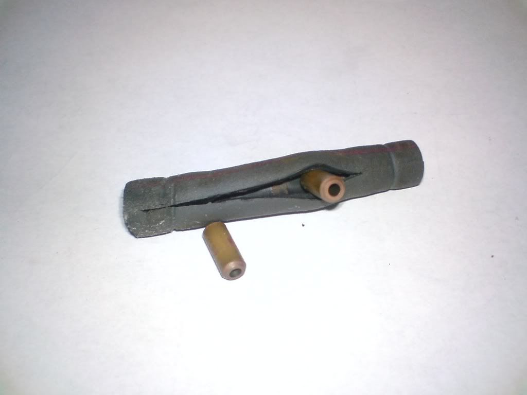

Okay, couple of things. In the diagram, I think it's 16-18 that you are asking about. The #8's are the upper vent tubes.
I'm glad this post came up. I just finished the rebuild of my K8 carbs and had no idea those little brass inserts were even in there. My tubes were old a cracked as well and so I replaced them with some clear tubing. After reading this post I went back to the trash at my work bench (which doesn't get thrown out often) and dug one of those tubes out to look at it a bit closer. This is the big one of the three (#18) and it has two little brass tubes. I took a picture:
What is the purpose of these little tubes? Should I put them into the new rubber? Do I need them?

Assuming that those brass tubes were not how the rubber tubing was attached (you obviously were able to attach your new tubing to the carb bodies right?) then they could either be some sort of restrictor or something to keep the tubing from colapsing.  These lines are the supplies for the accelerator pump nozzles.  The pump is on the #2 float bowl assembly and pushes the fuel from there to the other 3 carbs.  Perhaps it is somehow beneficial to the fuel squirting process to restrict the connecting hose ID?  Or perhaps there was a tendency for the fuel line to colapse due to the heat of the engine and maybe even a bit of a vacuum effect once the pump has done its squirting?  Don't know for sure but you can see how well your new tubing is working by observing the pump nozzles (fuel on, air filter off, these are the brass nozzles located next to the choke plates on the bottom of the carb bore) and wacking open the throttle quickly.  Fuel should squirt down the carbs throat.  However, you still might not be able to tell whether those brass pieces would have made a difference in function, particularly if it is an anti colapse device and requires a hot and perhaps somewhat aged fuel line before its services are  required.  Hope this helps.

I just check measurements:
Two brass inserts per tube.
Center tube inserts measure 12mm each.
Outer two tube inserts  measure 9.5mm each.
Yes, the tube attach to the carbs via nipples on the carbs. I would assume that you have it right about them being either anti collapse or restriction devises of some kind.

i guess you really don't need those little inserts but for some extra safety so they won't kink with the heat and pop off I say put them in the replacement line,don't really think its a restriction thing,just support,,,,those accelerator super small squirt spray nozzles are enough restriction,,,was thinking of oversizing the squirters with a micro drill bit
