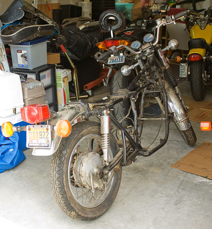

Here's how it looked when I picked it up,

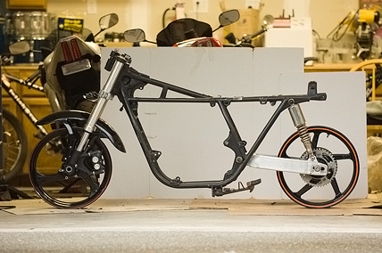

And here's how it looks now,
So far here's the list,

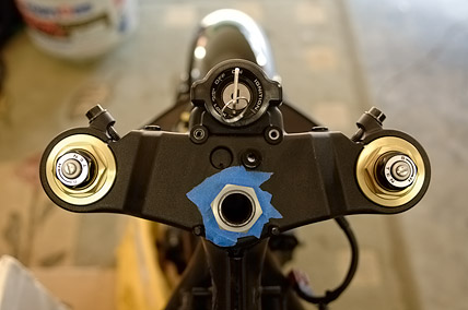

'75 frame, being cut down to the bare minimums and having a little extra welded to it,

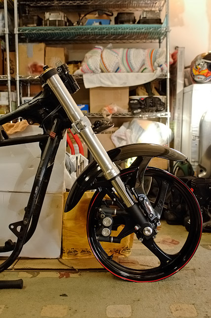

'06 CBR1000RR front forks, triples, wheel and ignition
(the stock cb stem had to be pressed out, extra material welded to it, and then milled down to fit, work done by
Zoran at TwinWorksFactory in Reno, NV)
'06 R6 front brake calipers
'06 Ducati Monster Fender, bracket's made in order for it to fit
'00 RC-51 kickstand, no idea if it's long enough yet

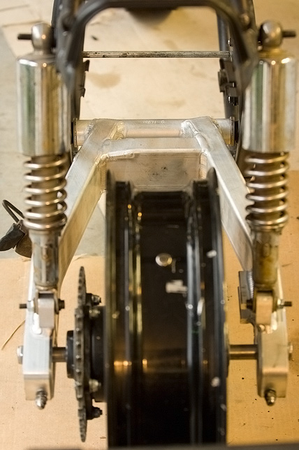

JMC swingarm for a 160 rear tire, unfinished for now, but will match the forks
RS250 17x4.5 rear wheel
There's a lot in the works, but I'm hoping for something that looks like a more modern version of Dick Mann's CR750.
It's also going to have a DOHC motor, so I hope you don't all laugh at me, ;) I'm looking for a black '82 750F if anyone knows of one.

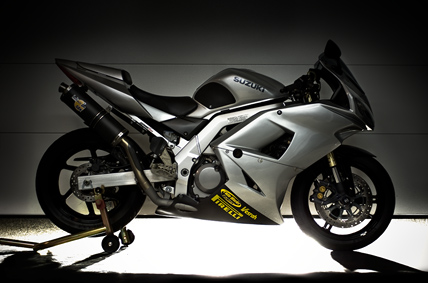

Here is my last project, not to everyone's taste I'm sure, but I love it, my version of an '03 SV650S,
I'm also a photographer,  ::)  ;D
Wish me luck, thanks for all the great info so far on this site!
-peter

The swing arm is a custom job done up by JMC over in the UK, it's made to fit up to a 170. I wasn't very happy with their service though, it took them over four months to get it made (they quote you 6-9 weeks), they raised the price half way through saying that the online ordering had messed up, over one hundred dollars, and never got back to my emails.
You also have to deal through a nice lady named Maria in Puerto Rica, the US supplier. But every time you have a question, you have to ask her, then she has to ask them, and then you wait... and wait... and wait... and sometimes get a reply back. Overall it's a nice and light swingarm, but I was very unhappy with the service.
I ended up paying 700 something for it w/o the polishing (costs extra), and that was back when they were running a 200 dollar discount.

The reason I asked about the swingarm is I see people taking them off other bikes and modding them.. welding without re heat treating usually will come back to bite you.

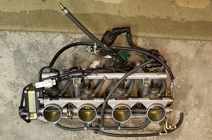

I have these waiting to be fitted and installed, 2003 GSX-R600 throttle bodies.

I agree with you on your classification of a "Hot Rod" Irish.
A SOHC motor was originally planned, I have a '73 motor and '77 auto as well in the garage (that I now have to get rid of), but they're torn apart, and I don't have the money to buy the parts to fix it up. Originally I was hoping to build a 90-100hp monster; an 888 when I was done.
But then after seeing an all black DOHC I kind of fell for it, I just like the look of it, and I think it fits, visually, with my project more so than the classic lines of the SOHC.
If I were to ever build a naked 750, it would have to be a SOHC.
And that skyline swap guy sounds like an idiot, ;) haha
-peter
