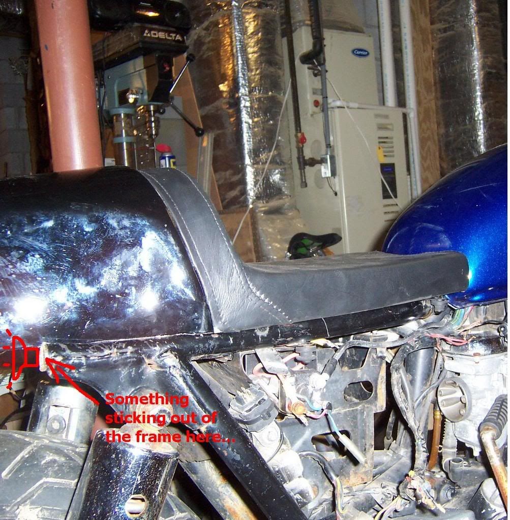

Anyone have any experience with this?  I've searched the forums and have some good leads, but I don't know exactly what I should be looking for...
I'm trying to put 2 projecting LED tail lights sticking out of the back of the frame here...
Any suggestions?  I'm also on a budget, so any lower-priced options would be great.  I'm just looking for tail/brake lighting (maybe connect them for turn signals, too?  if possible...)

Re: Putting 2 LED tail lights on my cafe...
« Reply #6 on: October 24, 2007, 08:13:04 AM »
Interesting solution for a non-skid seat Dan ;D
hahahaha...  That gave me a good laugh this morning, thanks man  ;D
Here's what it looks like with the whole deal installed:
I'm basically looking to have an LED pod that will stick straight out of that hollow frame end, then drill the frame farther back for wires to feed in.  I'm sure I could easily fabricate something that I would glue in there with silicone or liquid nails, but I don't know where I can get the socket from, or what it would really look like.
And I plan to use a 10 or 12 LED pattern bulb, so it should be plenty bright during the daytime.  And I'll have 2  ;D

Here are a couple of links.
I`ll probably be doing this to the CJ360 rebuild as well.
http://cgi.ebay.com/ebaymotors/2-Red-LED-Brake-Tail-Lights-Go-Cart-Sand-Kart-Off-road_W0QQcmdZViewItemQQcategoryZ46092QQihZ010QQitemZ200134388012
http://cgi.ebay.com/ebaymotors/Red-LED-stop-tail-turn-Lights-Motorcycle-ATV-Trailer_W0QQcmdZViewItemQQcategoryZ34284QQihZ010QQitemZ200135722488
Looks like those housings are going to be too big to fit inside the frame tube.  I measured the tube at 3/4" inner diameter and 7/8" outside diameter...
CB750K4
