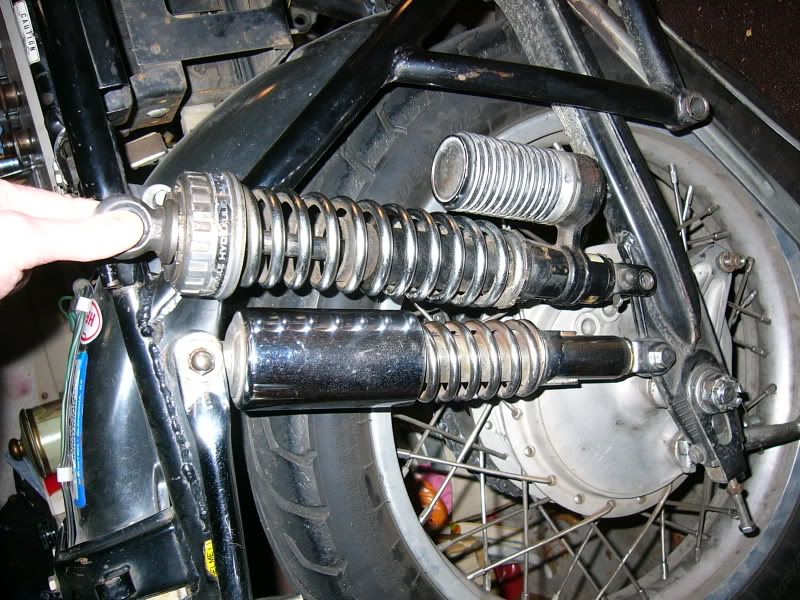

Just thought Id add this for anyone thinking of doing the same..today I tried fitting my Ebay purchase - CB1100F shocks with remote reservoir to my CB750K2 with stock HM300s....no good...the rear reservoir (when at rear of bike) hits the pipes before they can be secured to frame......if Im wrong someone tell me!!

Sounds about right, I haven't seen that shock on any bike with 4 into 4.

You might have already tried this, but can you swap the shocks to the other side?  The reservoirs are angled away from the bike slightly.  Maybe pointing them inward would clear the pipes...of course it might foul on the brake or the chain.

Yes, shifting side may solve the problem with the reservoir hitting the pipes.
However you will probably run into another problem and that is the swingarm hitting the inside of the lower pipes.
It did on mine but since I was modifying my rusted out pipes anyway, that problem was easy to solve  :)
Might be harder on stock pipes unless you want to dent them for clearence  ::)
Hopefully not an option!

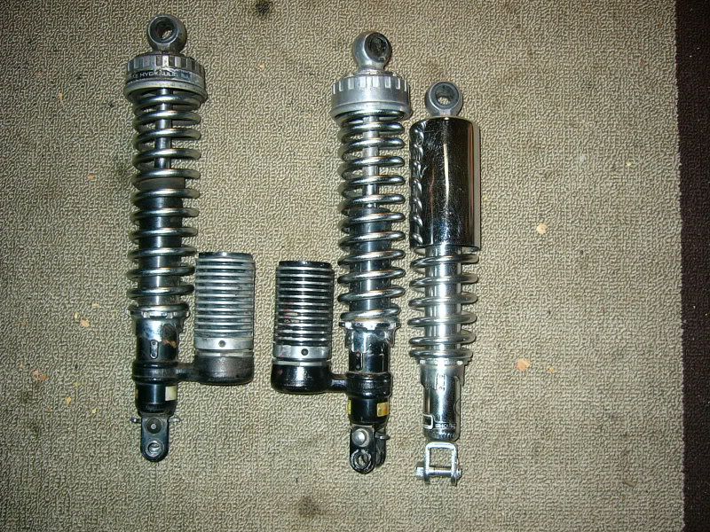

  • Posts: 8,041
Re: CB1100F shocks dont fit on a CB750 with stock pipes :-(
« Reply #11 on: January 22, 2008, 12:24:25 PM »
CB1100F are 14` - see pic of them next to stock....
cheers
Andy
75modrat
« Reply #12 on: January 22, 2008, 12:46:23 PM »
Andy, thanks alot. not only was that informative, it put it in a format I could understand...Pictures!!!. Thanks again.
