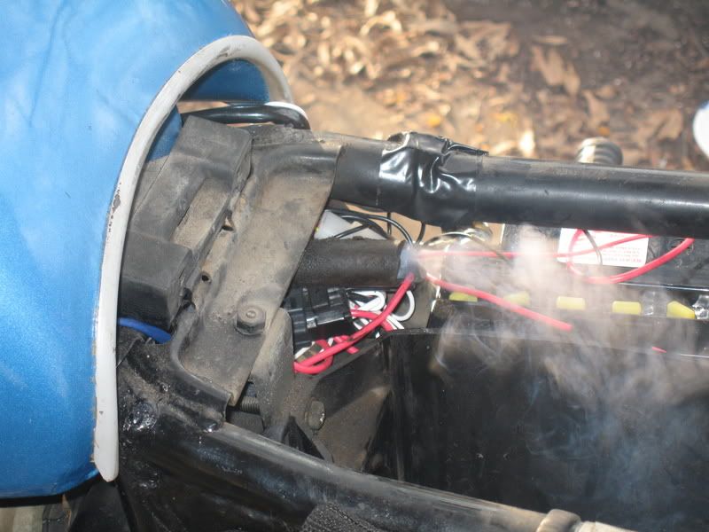

I picked up a two foot heater hose that I ran from the head to about the end of my exhaust pipe. I did it that way because I didn't have room to run it between the carbs to the bottom of the bike. It works just fine for me. If you don't have an air filter, you'll want to get one. I wouldn't run without a filter for two reasons: One, these bikes were made to run with filters and two, you don't want stuff getting into the carbs. Now if you're planning on running with pods, then of course you wouldn't need the filter.
