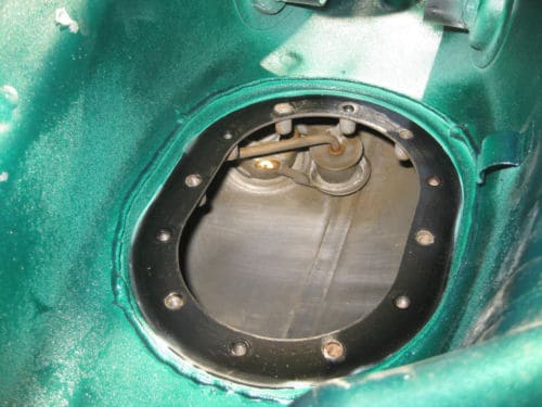

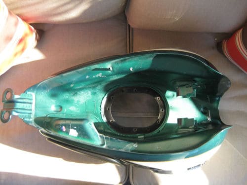

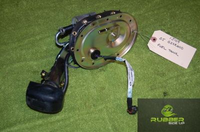

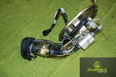

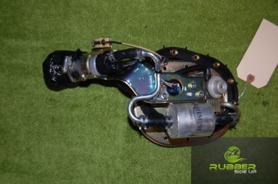

One thing I would like to add to the "database" of information in this thread is through my research for a fuel pump I found the late model Triumph pumps. The two I looked at are from the Bonneville and the Thruxton. They are a bit pricey but for those of you that want to keep a stock style tank without the issues of running an external pump it might be a good option. The pumps mount to the underside of the tank in the middle of the tunnel. The pickup offsets to the side and is mounted low which would put it approximately where the petcock goes. It would require some metal fab to cut out part of the tunnel and weld in a flange for the pump assembly but the outer shape of the tank could remain the same. Now I haven't tried this personally and I'm only going on theory here but it looks like a great way to go.
« Last Edit: December 30, 2011, 08:57:06 am by 65Ch3v3LL3 »

Offline Tintop
  • Posts: 3,965
Re: Fuel injection conversion (edit) fixed a few things
« Reply #493 on: December 30, 2011, 12:16:23 pm »
Very interesting find 65Ch3v3LL3.  If the plan was to do a custom tank, that would be a very clean install.  Thanks for posting that.

  • Posts: 33,281
« Reply #495 on: December 31, 2011, 03:43:19 am »
Geez that's a lot of gear to stuff in a SOHC tank, also, you might run into problems with the frame's backbone interfering with the positioning of the unit inside an SOHC4 tank? Cheers, Terry. ;D
Offline 65Ch3v3LL3
  • Posts: 195
« Reply #496 on: December 31, 2011, 03:56:37 am »
From looking at them I'm pretty positive I could fit one in my 79 CB650 tank and the 750 tanks are similar sized. But like I said its just conjecture at this time. I'm going a different route or I would try it but I just wanted to throw it out there as a possibility. I have a few 650 tanks laying around. Maybe one day when I'm bored I'll give it a shot!

  • Posts: 33,281
« Reply #497 on: December 31, 2011, 04:00:58 am »
No worries mate, and I'm not trying to pee on your parade, I'm just looking at the flat bottom on that Triumph tank and trying to think where you'd mount that gear under a CB750 tank. Cheers, Terry. ;D
