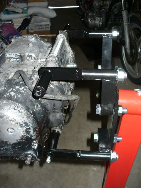

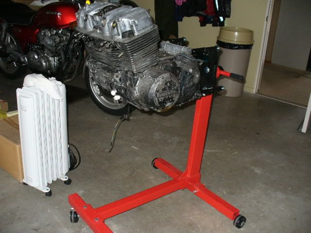

Hi. When I pulled the engine out of my 78 F2 I bought an engine stand for NZ$85 and made up some brackets to fit the engine. Have a look at the phot's below to see what I mean. Cheers, Roscoe
Hope this helps.

I like that engine stand----
Its easy to use. You can turn the motor 360 degrees to work on. They are for sale on www.trademe.co.nz for NZ$85 new. I'm not sure about shipping to USA though.

been thinking of modifying a stand i have in the same fashion, but the two concerns i have are: 1) what do you do when you split the cases? and 2) not sure if i trust those little welds with my engines.

You can do it 2 ways. Either put the engine in the upright position and use the front and rear attachment points or make up a little extra stand to take the front pin. All it needs to be is a couple of 4 x 2's with the hole for the pin

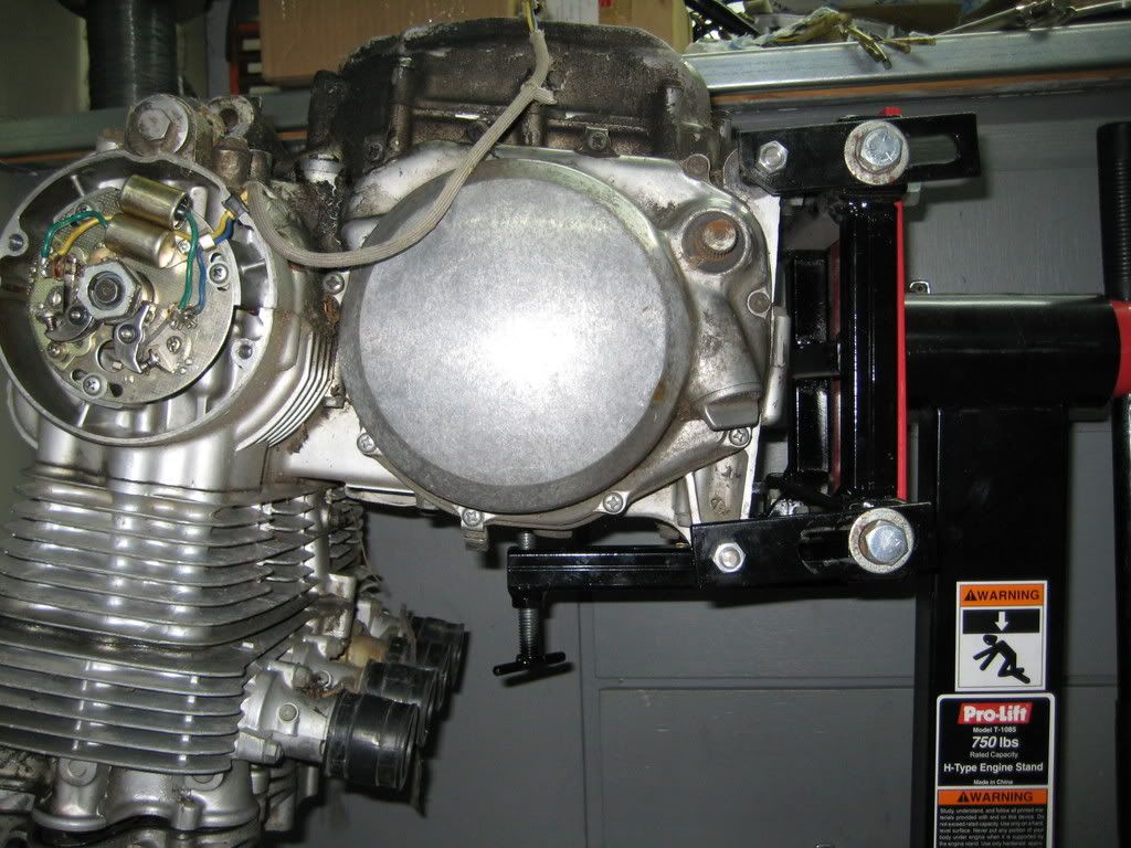

Here's another version. Like paulages mentioned I wanted to be able to split the cases without changing positions, just have to tighten the tensioner on the top case, spin it upside down, then pull the lower case bolt. I made the brackets adjustable to fit just about any bike engine.
It's a $35 Chinese special and although I'd never trust it with a automotive engine, it's supported several 750 mills.
that's what i'm talking about brent. flipping it upside-down especially important with the smaller fours.

I wouldnt trust a 750 motor upside down on the bracket shown at the top of this page.. that is a lot of weight to put on that thin tube.
On my stand we made it hit in the starter cavity so you dont see a mark,,bit we bent the first one..
