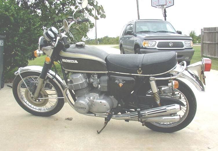

Finally have me my own 750. Been looking for a year now.  $450   '72CB750  20k on the odometer. Numbers seem appropriate for original.  - Not currently running.  Gonna pick up a new battery, plugs.  Got the carbs off and soaking in some Simple Green.  Going to give some "Rubber Renue" a try on the carb boots before ordering any new ones...  Came with some new throttle cables, so I'll put those on while I'm in there.  Change the oil & filter while I'm at it as well.  Been sitting for 4 years now...gotta get some new tires but I'm just gong to try and get it running this weekend.  Unfortunately, the tank has been kremed, doesn't look like a good job, so I'll probably have to address that soon.  Petcock looks good and clean...carbs should clean up fine.  Hopefully she'll fire up easily.  Going to have to rebuild the master cylinder & caliper....almost stuck - not quite.
Anything I'm missing that's easy to remedy ?
UPDATE:
***while cleaning the carbs, I discovered that the PO has cracked the post that the main jet threads into...not too badly - It still threads easily, but I'm worried that it will leak from the crack.   Anybody ever try a bit of teflon tape ?  Bad idea / good idea ?  should I just hunt down some new carbs and be done with it ?  Gotta order some bowl gaskets for it and was thinking about getting some new jets & needles while I'm at it.
Here she is:
I might even resist the urge to cafe this one.  The chrome and pipes (341's) are in really good shape.  Somewhere along the line it has been cleaned up a bit...  Dangit I wish I didn't have to work today & tomorrow.

Pretty clean looking bike there. You got a good deal I think.

Nice deal!  Looks good.  I'd check the points and possibly order some while you're at it.  One less thing to worry about.

Nice.  That's too nice to mess with(if it were mine, but it's yours, not mine).

Dude,  It looks great!  Now chop it up and make a cafe out of it. Ya know you want to.  ;D

That's a very nice looking machine.  Let me know if you find any more deals like that. :)  The green is a beautiful color on those.

Well.....it's more of a brown than green...   I'm thinking of the Candy sunrise orange, or a transparent rootbeer w/ correct stripes...  could go either way

I dunno why I thought that looked green.  Almost looks black in the pictures.  Oops.

Very cool bike in what looks to be very good condition. Sunrise orange is sweet also. :)
