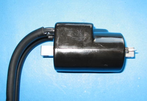

I have a 750sohc 74 engine.  I have coils that I think would run a cb750  they are these   http://i252.photobucket.com/albums/hh19/revjimmc/DSC00873.jpg  http://i252.photobucket.com/albums/hh19/revjimmc/DSC00872.jpg
will these work for my engine?

What are they off of?

they are off of a cb650 I believe...maybe a cb550.

Those aren't from a CB650 unless the '79's were different from '80 and later.

hey man whats up??  yeah i think those will work.....take an ohmmeter and measure the ohms on the connectors.  if you have points 5 or 3 ohms will work...if you have EI ignition....you need 3 ohms....but if i am wrong i am sure someone will say so.  i have a dyna s ignition and coils from a honda cbr 929 that are 3 ohm,  and she never ran better.  i had stock coils with the dyna and was having weak spark problems.  but that is another thread.

come to think of it revjim....i looked more closely at your pictures....i think those coils are off a newer bike, those brackets are similar to the 3 ohm coils i got...i think they are 3 ohm, and will work with points or even better a EI ignition.   use those coils and upgrade later, but yeah i am pretty sure they will work.
