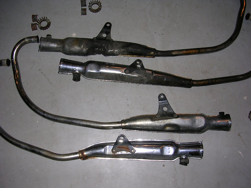

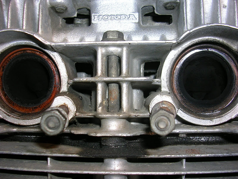

Since the weather is supposed to be bad for the next week or so, I pulled the pipes off to get ready for the new chain.
I drained all the oil out, and am cleaning up the oil filter case before putting it all back together.
With the pipes off, and the oil drained, it would be pretty easy to drop the oil pan and ensure the screen is clear and get all the grit out.
It seems that every step forward leaves one more thing to do, and to learn how to do. This is awesome.
Anyone have an effective way to clean all the built up carbon in there?
With the pipes off, its a lot easier to notice the rust spots and holes.
Can I just use JB Weld or should I start looking at new pipes?
I kind of dig the whole 4 into 2 pea shooter exhaust, but are there kits for a CB550?
EDIT*   (Stupid Question Time) Do I have to drain the gas tank before I remove it? Everything I've read says just turn the petcock off, disconnect the lines, and then take the tank off. Am I an idiot? I don't want to spill gas everywhere. Thanks

you need a head gasket , just a little FYI
add ther are several different aftermarket pipes for the 550 , Kerker, Mac, Yoshimura(good luck finding a yoshi though)

Once the stock mufflers start rusting through, the metal is too thin for a lasting repair.
You're going to need new compression gaskets before putting headers back on the bike.

Yup looks like a leaky head gasket......
Don't get discouraged bikes run for years with leaky head gaskets....
As far as the carbon build up in the exhaust ports ....I wouldn't bother cleaning it out.
Doesn't hurt anything and its right back after you run the bike any length of time.
That one muffler is shot.
Try Ebay and join the rest of us in our addiction

*Noticed the bottom left exhaust (#2?) weld is blown out where the exhaust meets the header. (Anyone in NOVA handy with a torch?)
A guy in Falls Church did some welding work for me - if you want, I can pass his contact info along.  But if the pipes are rusty there's probably no hope for them.

Today I'm going to try and clean up the pipes a bit, throw a little JB weld on them and see if they feel like holding together until I can afford a new set.

I also cleaned up the exhaust pipes, and they look in fair condition. one pipe is clear, the other three have varying levels of rust, but I think its fixable, at least for a daily driver. Hard to believe that the second one from the right was the scummiest of the four.
I think JB Weld may do the job for a bit.
