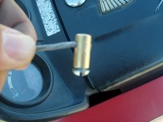

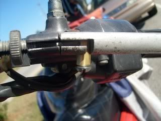

Just had my pull cable snap today about five miles from home - and here's the trick for getting home.  The cable snapped right up at the barrel, so I slid the frayed cable end out from the control, and tied a knot at the end.  I then took the ring off my keychain, and threaded it onto the knot, so that the terminal end was now attached to the ring, rather than the throttle control.  I then slid the ring over my thumb, so that to accelerate, I only needed to pull on the cable by closing my fist while holding the grip (i.e. pulling with my thumb) and to decelerate, just let off with my thumb.  It wasn't pretty, but it got me home.

Continuing from the bag of tricks....  ;D
At my last trip the pull cable broke somewhere in the middle about 100 miles from home. I fixed it in 20 minutes. How? By swapping teh cables at the carbs, so I came home (and I'm still driving, new cables are coming) by not "pulling" the grip, but "pushing" it forward. It was a bit strange at the beginning, but works perfectly, and I consider this an "elegant solution.  ;D

Back in my old VW mechanic days, I carried a short peice of copper tube - just big enough to fit over the cable.  Slide it in and "crimp" it with pliers.  Works quite well for breaks not right at the ball.  Combine it with the repair clamps and you have both fixes.
