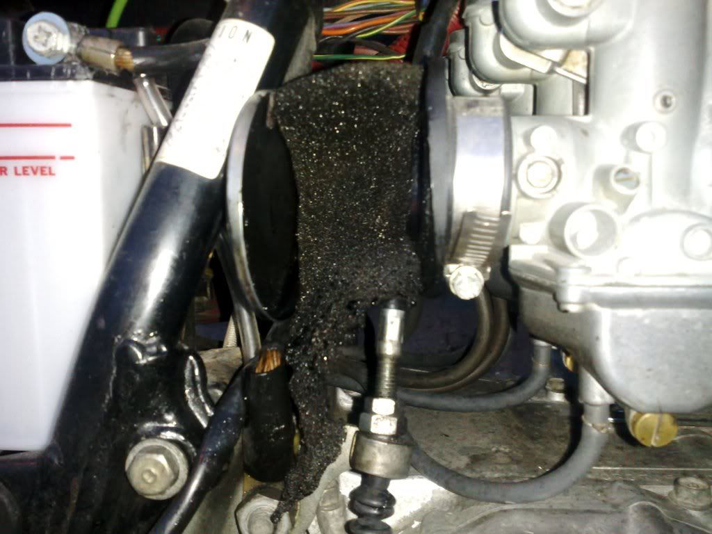

So I adjusted my valves last weekend because I was hearing some ticking, and now the bike runs like total #$%*. First it developed an exhaust leak (still have yet to find it), and then it sounded like it was detonating like crazy. I adjusted the timing, set the points, and it seemed to get a little better, but there were still the pinging sounds. I was so nervous about the harm I could be doing to the engine, that I just parked it at work and drove a car all week.
Tonight, though, I figured I would take her home since it was the weekend and I'm planning on tackling the problem tomorrow. Then, in the lot, I noticed this:
It's a totally shredded foam pod filter. And there was melted something-black all over my kick start lever and side cover. And my right pant leg has been smelling like gas lately.
Could I have been misinterpreting the popping noise as detonation, when in fact it was a backfire? The noise gets is worst around 6k rpm, and, up until that point, increases with revs. Thing is, it was running fine before; could I have caused it to backfire by adjusting the valves and setting the points?
And oh yeah, the ticking is still there, and I'm 100-percent sure about the valve clearances: Engine was cold, triple-checked everything.

I had a snowmobile do that  :(
It was two stroke of course and two strokes tend so spray back a bit of fuel when running (two stroke thing) and the filters had a bunch of fuel sitting in them. When she back fired, the filter caught fire and melted like yours.
Because the bike's a four stroke, I doubt that's what happened but maybe there is something going on with that carb which soaked the filter in fuel and either the foam didn't like it, or a backfire lit it up.
BTW, Backfires through the intake are pretty distinct. Hard to confuse with pinging IMO.

I had it happen with UNI socks....melted all over my gloves..  >:(
Go for cloth filters..
 The answer to your Q.. yes it can & did happen to you..

it looks like oil/gas disolved the adhesive that holds the filter together
+1    Looks like your carbs overflowed a bit while sitting and made a runny mess of your foam. If your float heights aren't set proper and you have too high/too low fuel levels in one or more carb then your bike will run badly.

That filter was melted, one of the backfires lit it off, and it only takes a second. 4 stroke dirt bikes put a metal screen under the foam filters to prevent this. Ethanol in gas can disolve glued seams but that one is melted.
Tight intake valves or incorrect timing could both cause backfires, and since that's what you did,.. better check them both. Crank position is crucial when setting valves. Did you have to adjust any of them by a large amount, that would be a clue the crank wasn't positioned right for that cyl. Did your timing marks move as you revved it and did they stop between the two marks?

I also think it was caused by backfire through the carb.  Gas shouldn't melt pod filter foam, they are made out of gas/oil resistant foam.  Backfires out of the carbs are due to way to far advanced ignition timing or intake valves too tight and not closing fully.  Did you check your cam chain tension before your valve clearance?  Both valve adjustments and timing are suspect so I would go back over them very carefully.

So I had basically parked the 550 for a couple weeks because I was pretty bogged down at work. Finally took a deep peek today, and HOLY S#IT. Turns out the valve adjustment screw on the #4 cyl, the one that toasted my pod, had somehow come OFF. Operator error, I'm sure. The screw was just sitting there on top of the valve... I hate to think what the inside of that cylinder looks like now, but thank god for bulletproof hondas: re-adjusted the valves, tweaked the timing, and synced the carbs, and the bike runs beautifully now.
