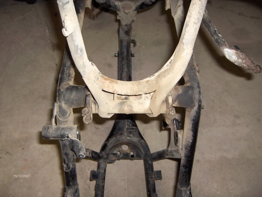

You should have a look underneith the bike to see if the clamp brackets are still in place for the center stand. If the stand has been removed, than maybe the remover cut off the brackets too. Might be some pics on here somewhere but basically they look like two brackets with about a one inch hole in them and they are sloted to work as a clamp.
If you have the brackets then it's a simple matter of getting all the hardware to bolt it on... and the center stand itself.

Are the the same place were the front peg bolt to? bracket right behind the engine that has a open slot facing down with bolt running through it and the foot pegs are on either end.

« Reply #3 on: May 11, 2008, 05:20:15 PM »
no it should be slightly down and in front of what you mentioned

« Reply #4 on: May 11, 2008, 05:46:27 PM »
I do have a pic after all...... this is a CB350F frame, I'm not sure if the 500 is the same
 Matt.

« Reply #5 on: May 12, 2008, 03:57:12 PM »
guess It does have them.
here some pics form underneath in case I completely miss understanding (which is totally possible)

« Reply #8 on: May 13, 2008, 08:44:25 AM »
i got one on line and just use it when i have to work on the bike. Its really easy to place the center stand in place then slide the rod through while the bike is on the side stand. stand the bike upright and presto. If you do it this way you dont need the spring or the D shape bracket/holder.
