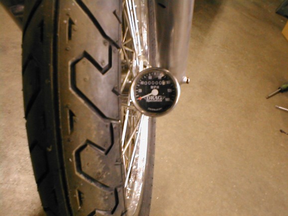

I want to mount a fork leg speedo to my 74 CB 550.
1. Where are you sourcing the small speedo's?
2. What cable did everyone use?.....any tips,sources for a premanufactured one?....Or how I go about making a reliable & good looking one myself.

« Reply #4 on: October 01, 2009, 06:51:56 PM »
Speedo in pic is from Drag Specialties, they probably still have, just need the right ratio (think there is only 2)

« Reply #5 on: October 02, 2009, 09:23:55 AM »
Thanks for the quick responses!
That speedo is probably the ticket, I am writing them this morning.
