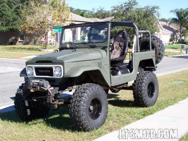

corbinwelter
Re: Squirley's 550 CAFE Build
« Reply #30 on: May 22, 2008, 07:45:39 PM »
Nice build up, and nice Jeep, your driveway looks familiar to mine.
Offline squirley
  • Posts: 418
« Reply #31 on: May 22, 2008, 09:19:15 PM »
Nice looking fj.  Growing up my dad drove an  78 for years. Great rigs.  I initially was going to build one, but the cost got so high for a mildly good condition one.
