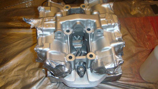

I forgot, I also cleaned the carbon deposits off of the valves.  I used a brass rotary brush in my dremel, and chucked the valve in my vise, the carbon came right off.  I then realized that to get the upper side of the valve face, I could put the dremel in my vise and chuck the vlave into my cordless hand drill.  I turned on the dremel about speed #4 and spun the valve with the drill, being very careful not to hit the sealing face.  It worked a treat and took no time at all.  However, the brass brush was pretty much done in after the 4th valve.
« Last Edit: December 17, 2013, 11:55:53 AM by dagersh »

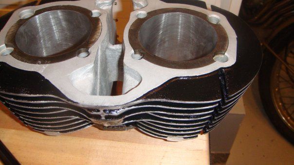

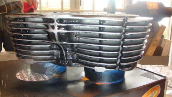

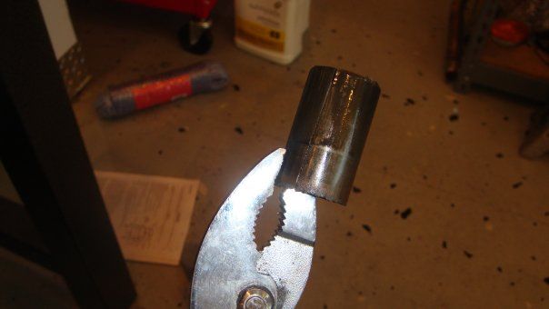

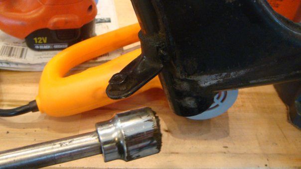

So its been a while, but I am back at it, thanks to the holidays!  I spent a great deal of time looking after little jobs that need to be addressed before I reassemble the engine, and also while I am waiting for parts.  I decided to go with the 74mm Todd Henning Racing pistons and copper gasket.  The pieces arrived in very short order, and they and the jugs are off getting over-bored.  I will post pics when they return.  They are porno cool!
So my week started with a lot of smaller tasks to bring up to speed.  There was much aluminum polishing to be done before reassembly.  First up was the  engine case bolt that had snapped while removing it.  The process was very easy, much to my relief.  I had prepped the broken piece with PB Blaster, and a bit of heat.  I drilled into the broken piece and then tapped the extractor in with a smaller ball peen hammer.
The threaded remnants were pretty much stuck to the extractor, but some heat and work with some pliers freed it up.  The practice was good when I stripped the bolt on the fork lowers….  Looks like I will have to replace that one…
« Last Edit: December 17, 2013, 12:08:13 PM by dagersh »

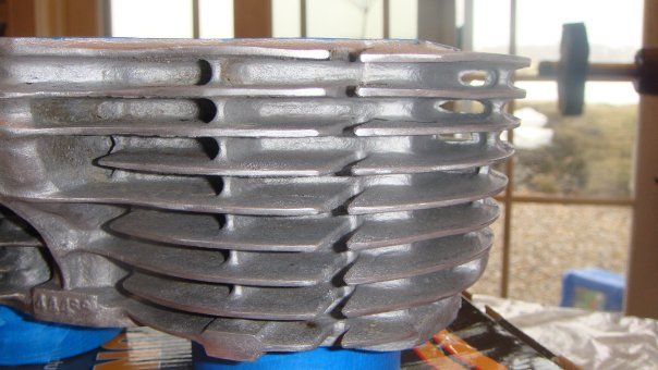

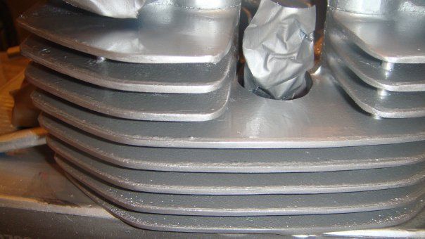

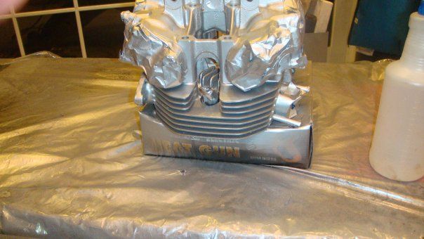

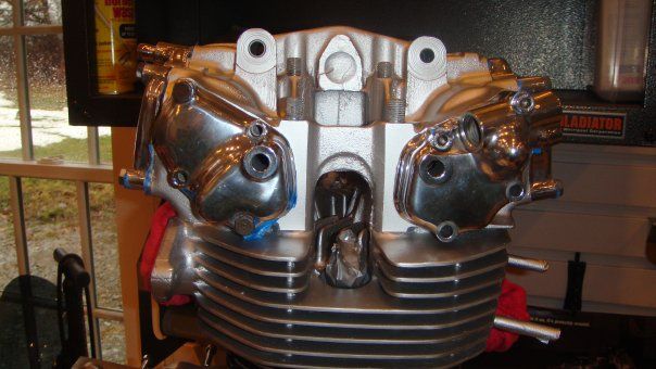

Here are the Cam Chain Covers on the head.  I wanted to document how I polished them.  I was going for a chrome like finish, and the pics do not do them justice.  Here is my method, and I have spent the holidays working on all the aluminum engine covers, fork lowers, triple clamps, engine mounts, and whatever else i could think of.
Most importantly, this is a very dirty and dusty process.  You must wear a mask, eye protection and gloves. Keep a vacuum handy in order to keep the dust and grit produced at bay.  It will get EVERYWHERE!!!!!!!!
These are the two covers (fore and aft) the shinier is after the Tripoli, but before the Jewelers Rouge.  I should note, I am using a Blador buffer with 3/4 inch arbor.  The first step is Emery on a Sisal 8" wheel.  I then use Tripoli on a cotton sewed 8" wheel and then Tripoli again on a loose sewn wheel.  The final step will be Jewelers Rouge on a loose sewn wheel, which will give the piece a chrome-like finish.  I have found that heat and a good amount of compound on the wheel imparts the best results.
The Emery Compound on the Sisal wheel will be frustrating.  Black residue build-up will happen constantly, but, do not despair!  After you are sure you have hit the entire part and knocked down the worst of the oxidation/crap, clean it with acetone and hit it with the Tripoli.  Let heat build-up in part, and you will start to see your goal.  It is quite pleasing.
« Last Edit: December 17, 2013, 12:28:58 PM by dagersh »

I was interrupted on the last post, and did not realize it actually posted.  So here is the piece after the Emery on Sisal.  it will remain a bit cloudy - the camera makes it look much more so than it actually is - but, that will disappear in the next step.  A tip with the emery on sisal; reload the wheel about every 30 seconds, it is really hard to keep up the heat.  When reloading, only apply your bar of compound to the wheel for 2 seconds, you don't need a lot, just enough to keep some fresh compound on the wheel.
I then move on to the Tripoli stage, where you will really get to see a huge improvement in the finish of the part.  I use both or either a tight or loose sewn wheel with a decent amount of compound loaded on the wheel.  I try to be able to see some brown on the wheel (Tripoli compound is generally brown), but as soon as you start on the part, it will quickly become black.  When I see black residue start to collect on the part, I will load up the wheel a bit more compound, again, for about a 2 second period.  The part will start to get pretty hot.  Make sure you keep it moving, but the heat tells you work is being done.  Depending on how many contours, bolt holes and tight crevices are on the part, I will move on to the loose sewn wheel with the Tripoli, again using the same principals.  If there are really hard to reach areas (i.e. Master Cylinders between the reservoir and the mirror mount), I will use my Dremel with a felt bob loaded with Tripoli.  This Cam cover is pretty flat, and between the sewn and loose-sewn wheels, I was able to get a good cleaning and polishing.
The example is now on the top...
« Last Edit: December 17, 2013, 12:48:00 PM by dagersh »

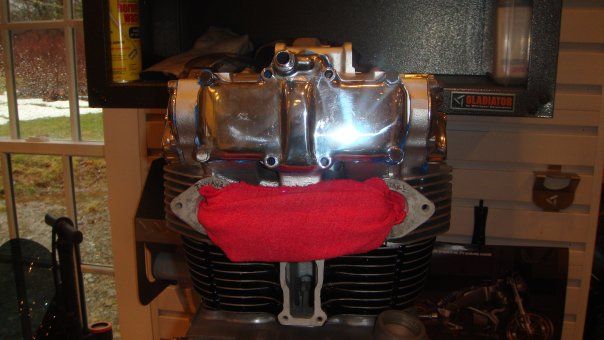

I then use Jeweler's Rouge (JR) on a loose sewn wheel and go over the pieces again.  Its the same principal as the Tripoli.  Reload your wheel every minute or so - you will figure out your own timing.  It is interesting to note, that the JR creates much more heat than the other steps.  You will soon see a gorgeous shine that will be much more refined than what the Tripoli accomplished.
Here, the example piece has had the JR steps done, and the shine is much better than the lower piece after just the Tripoli
One thing I forgot to mention - use acetone on the parts in-between steps, or also if you are getting a lot of black residue building up on the parts.  This removes any excess wax from the compound and will really help your progress.  Give the pieces a final rub-down with acetone and move on to Flitz, Wenol, Simi-Chrome, Mother's or whatever your favorite metal polish may be for the final step.  I tried to use Wenol with a wheel - but don't waste your time, it has to be done by hand.  Before reassembly, I am going to see if some good car wax will help to protect the shine.  My bikes live inside, so I am not too worried about future oxidation.
Over the Holiday week, I went over all the pieces I had already done, as well as the rest of the engine covers, the rear brake panel, fork lowers and upper triple tree – along with whatever else I could get my hands on!  I was also able to polish up the engine mounts, which are steel.  My first step was to glass bead them to remove rust and oxidation.  They were slightly pitted from this process, so I wet sanded them with some 180 grit paper using WD-40 as a lubricant.  I really only did this to make the polishing on the wheels a bit easier.  I was kind of feeling my way through this, so I don’t know if it actually helped anything.  I them went through the 3 different compound steps on the buffer.  One thing about steel and polishing…  IT GETS WICKED HOT!!!!!!!!  Make sure you are wearing very good gloves!  You can easily boil water on these pieces, especially during the Jeweler’s Rouge!  But they sure did come out nice!
I have more pics, but I need to load them later.  Back with more soon.
« Last Edit: December 17, 2013, 12:51:29 PM by dagersh »

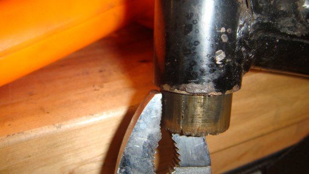

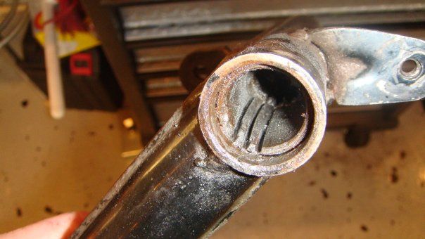

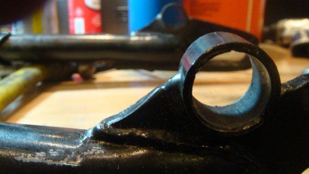

Bike down to the frame.  I was surprised at how easy it was to remove the steering head bearings.  My next step is to strip off the paint and fill in and complete the welds.  Also, I am going to have the tires stripped off and I will then disassemble the wheels so that I can polish the hubs.
More polished parts.  The brake stay came out really nice.  I want to speed drill it a bit to make it more interesting looking.
Parts on the shelf.
I quickly put the engine loosely together to protect the internals from all the polishing dust.  It was also nice to get some more work surface clear.  Looking forward to this weekend and more progress.
« Last Edit: December 17, 2013, 12:57:18 PM by dagersh »

I got a lot of stuff done over the weekend.  I had 2 goals, the first being to get the frame, swing arm and center stand ready for sandblasting and then powder coating, and the second being to start on the cosmetic restoration of the engine.
Someone said in another post of mine that after the Armageddon, the only things left will be cockroaches and the shock bushings in Honda Swing arms!
I did not have a press, and after bending up a bunch of washers and bolts attempting to press them out, I resorted to my new favorite tool, the air saw, to cut them out of the arm..  It worked great.
Shock Bushings are out!

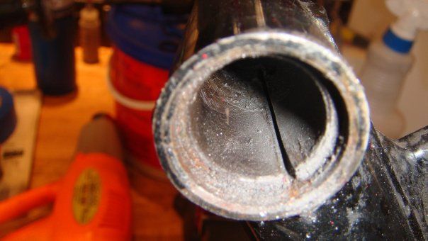

Next up were the swing arm bushings.  I learned a very important lesson here.  When you are taking these things apart, make sure you study the parts diagrams.  Study them CLOSELY!!!!  I thought I was cutting on a flanged bushing, and it turned out I was cutting on the swing arm pivot.  It’s hollow, but luckily, it is pretty robust.  I got even luckier when it started to slide out from the swing arm, and I was able to grab it and get it all the way out.  Although I put some nice cuts in the pivot, they were not deep enough to go all the way through.  I am sure it is still serviceable.
Once the pivot was out, I could then easily see the bushings which needed to be removed.
Here you can see the initial cut to weaken the bushing
A few more to further weaken it.
The cuts here are not all the way through, I did complete them, I was just trying to be careful as to not hit the swing arm surface.  The metal on the swing arm is pretty robust, and Hondaman has said not to worry too much if you actually cut into the swing arm, just make sure not to cut all the way through!  Caution and patience was my Mantra here.  It worked and they came out.
Once the cuts were made, and the bushing could be moved…
I drove them out with a socket on an extension (Gotta’ love Craftsman!)
Here it comes…
Here’s the Bugger!
Alright, everything was out, and off to my body shop to be sandblasted.
Now on to the engine.

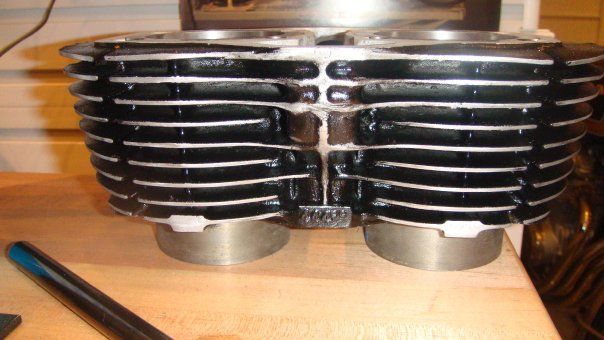

I spent hours cleaning the cases, including running them through the dishwasher.  I was not happy how they looked, so I decided to paint them.  I also really like the finished look of filing the fins and then polishing the outer ends.  The casting looks really unfinished from the factory, and smoothing and polishing the ends makes a nice visual impact.  I used a Fein Multipurpose Tool, going through 60, 80, 100, 120, 180, 240 grits.  Here is a picture of the machine:
It works really great for this purpose.  I was able to do the Jugs in about an hour, and the next day I did the fins on the head in even less time.  I then masked up the Cylinders for paint.
For prep, I doused the piece with acetone, and when that dried, I doused it with Brake Cleaner, and let it evaporate.  I made very sure to wear rubber gloves and to not touch the piece.  I used Duplicolor Engine Enamel Semi-Gloss Black on the cylinder, and would later use the same brand later in Aluminum on the Head.
I let the paint heat up in a warm pot of water for about 10 minutes, until it was just uncomfortable enough to hold.  I then shook it vigorously for 2 full minutes.  The first 2 coats were light, with 10 minutes in between all coats.  In between the coats, I went over the ends of the fins on their newly flat faces with acetone on a rag tightly wrapped around my finger.  It worked great!
The first coat on…  the second looked about the same.
The finished product
I need to touch up a bit in front so thet the “web” will be more defined, but overall, I am really pleased with the results.

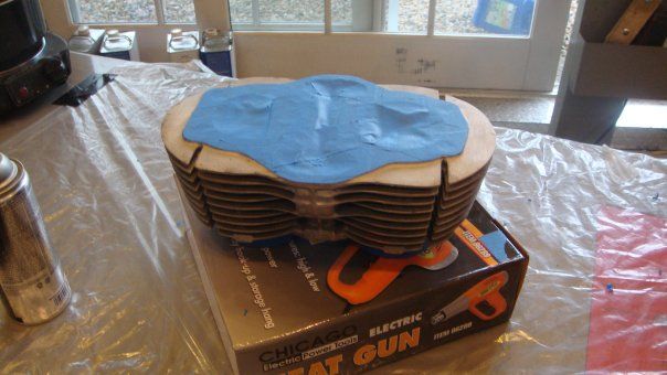

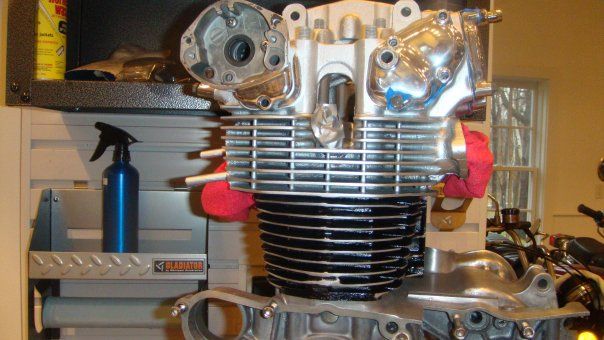

For the head, I found masking easier if I used all the Cam covers, pre-taped in low tack masking tape, to protect all the gasket surfaces.  I also wrapped the spark plugs, intake and exhaust ports to protect them from overspray.  I used the same prepping as the jugs, and painted the same way.
The sanded fins:
The masking tape pulled off, after the head was dry about 7 hours.
This weekend, I am considering painting the crankcases the same as the head, but I think it would look better a little darker.  Anyone that is thinking about painting your cases, do it, it is so easy, and really makes a huge impact on the looks of the engine.  I will also further polish the fins using finer grades of wet/dry paper to get a really nice shine.
I have also, while all this going on, been sending different hardware into my vibratory Tumblers to be polished.  These are really great, I let the process go on for a day or two, and the results are stunning.
Also, a question.  How do I restore the threads inside this wheel hub?
« Last Edit: December 18, 2013, 01:20:11 PM by dagersh »
