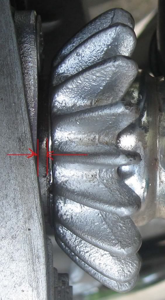

And, aren't ALL the exhaust flanges identical ? (In theory)  I can't get the number 4 pipe to fit all the way
onto the flange, BUT, they don't seem to slide on far enough (specifically the number 4 pipe) there is almost 1/8"
of an inch left that it could slide onto the flange.
I've tried taking it off and inserting the flange into the pipe...same result - doesn't slide far enough on there to
cover the slits on the header pipe.  I have cleaned everything, so there's not any rust/debris keeping me from sliding them on further.
Are the flanges numbered ?
Am i going to have to take everything apart again ?  Hate have to wait for new exhast gaskets again

Does the flange have to sit flush?   As long as the gasket is compressed and there is no leak, shouldn't it be fine if it sits out just a bit?
