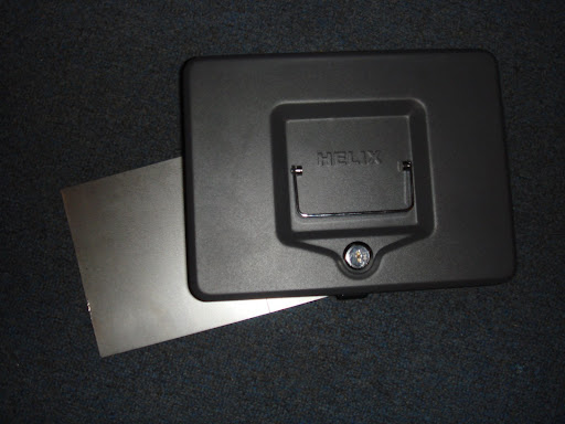

My side covers are trashed. Well, my left side cover is trashed. My right one doesn't exist. Good ones are pricey, somewhat hard to find and when it comes down to it even new ones are brittle plastic. I have yet to see the new blow molded covers for the '77 550. So while I wait to figure out where and how I should finish painting my engine (as stated previously the garage burnt down and we still haven't gotten the permit to rebuild the damn thing).
So here's my fix/work around. I bought two cash boxes (found two with matching locks!) from an office supply store. The better quality ones (ie sturdier steel, hinges and lock) all had a handle in the top. I figured I'd deal with it, and I made a run up to the hardware store and bought a small sheet of 22ga steel. I can't weld in any acceptable sense (where the heck is Martino when you need him...) and I think rivets will add a nice touch. I'll paint the boxes hammered black to match my tank's (new) paint job. The steel plate and rivets will get the copper to match the engine. Pictures of the tank's new paint job will come when I get around to taking them. For now, the start to my battery and electrics boxes:

Just picked up a filter for my crank case via feebay for $14. Kind of matches the Emgo taper pods. Since I'm running pods I'd rather not be sucking dust into my crankcase through the breather.
My two boxes are nearly complete as well, I'll mock them up on my bike for pictures when I do finish them up.

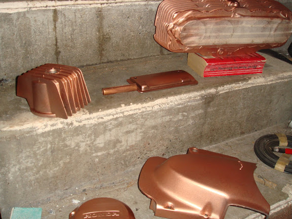

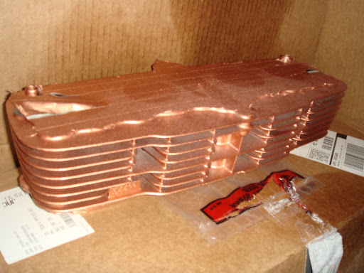

More copper. I have an actual piece of copper in both photos. It is next to the starter cover and oil pan. I'd say the paint is pretty accurate, and the pictures don't quite do it justice.
I'm happy with the results. I still need to paint the clutch cover, cylinder head, rocker cover, breather cover and case. Rocker cover, breather cover and case will be Rustoleum BB-Q black. Mufflers are going to have the baffles removed, they're rattling around in there, and replaced with my own fabrication of some sort. Holes in the exhaust will be brazed, large amounts of grime and rust cleaned off and painted copper. The headers will be wrapped in black exhaust wrap to cover up a number of deep scratches and dents.

I've finished the boxes for the sides (nearly, still need to clear coat and polish). Beyond that work and school has been keeping me busy (almost too busy). It's been slow tinkering since university has started back up, but it will likely be done by spring.

That copper paint looks real nice. Can you give me some more info on which paint you used?
Looking forward to see pictures of the engine all together...
