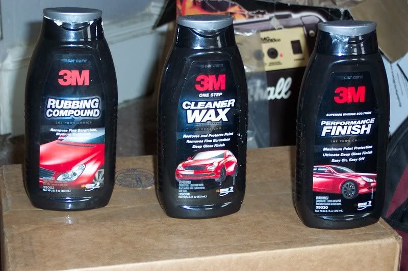

« Reply #7 on: July 04, 2008, 01:07:43 PM »
give her a sand down with 600 grit wet and dry to smoothen out that orange peel but before the next spray give it a generous wipe with mineral spirits or acetone to remove any grease remaining that acrylic enamel doesnt like grease  ;). Should be ok to lay down a couple more coats, especially if you want a deep gloss you really need to. Once you have layed down your final coat let it dry per the instructions times that by two and your ready to sand with 1500 grit. Look out for the low spots they will still be glossy while you dull the tank with the 1500 grit also make sure you have a good light to work with sunlight is best. Keep sanding till the glossy spots are gone then you can be sure you have a smooth surface. I used the 3M system on my tank it came out unbelievable here's what you need to get it looking like glass use from left to right...good luck!
