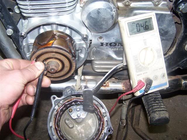

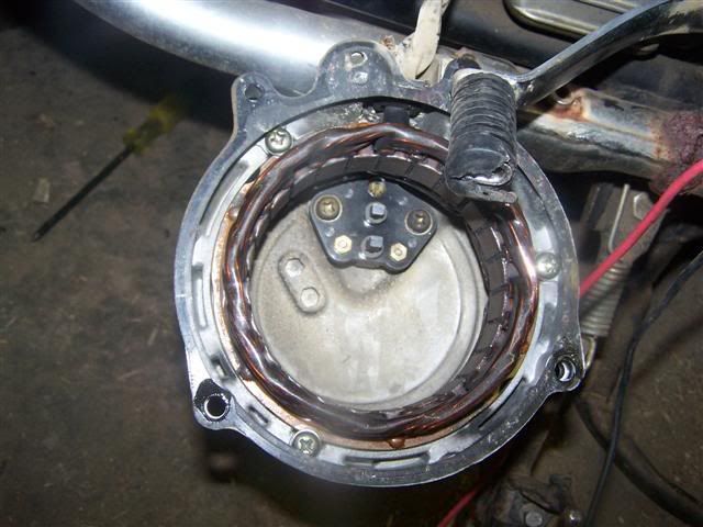

oke,i took off the alternator cover for you....
if your carefull,you can safe the gasket...and there is no oil there..
here you can see the inside of the cover,it has the coils in there and the 2 brushes for your black and white wires..
now i took my ohm meter and went directly on the rotor,where the 2 brushes run on..
and there it measured this..
4.6 ohm...

i measured it on the cb650 with the higher reading off the black and white wires,theres no battery in it,but that shouldnt matter..
on the front side of the rotor,you can see the 2 shiny "rings"where the brushing in the cover slide against..
if you look at my last picture you can see i have the 2 leads from the multimeter straith on those 2 rings..
i would start by measuring those,i came up with 4.6 ohm,this will tell you if your rotor is oke..
i asume you could clean the rotor with scotts brite or a fine sanding paper,you dont have to clean the entire rotor,just where the rings are is good...
if the rotor rings measure out oke,i would clean the rings,and the brushes...
what i also did was put one lead from the multimeter on a brush and the other lead on the connector plug at the r/r....the top brush will be the black wire,the bottom brush the white..
it measured out 0.2 ohm on both the black and white,telling me the wires are oke..
then i shorted out the brushes(by laying a bolt from brush to brush,connecting the 2,and then measured at the connector between black and white,i came up with 0.1 ohm again..
so that tells me,that it was dirty rings and brushes..

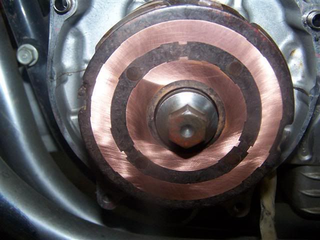

well,i went ahead and cleaned the front of my rotor,took less then a minuted,but it shows clearly what rings we are talking about..>>

Did the same thing... read 4.6 ohms ring-to-ring at first, then 4.4 after cleaning.  Read brush-to-plug and black was 0.4 ohms and the white hovered around 0.7.

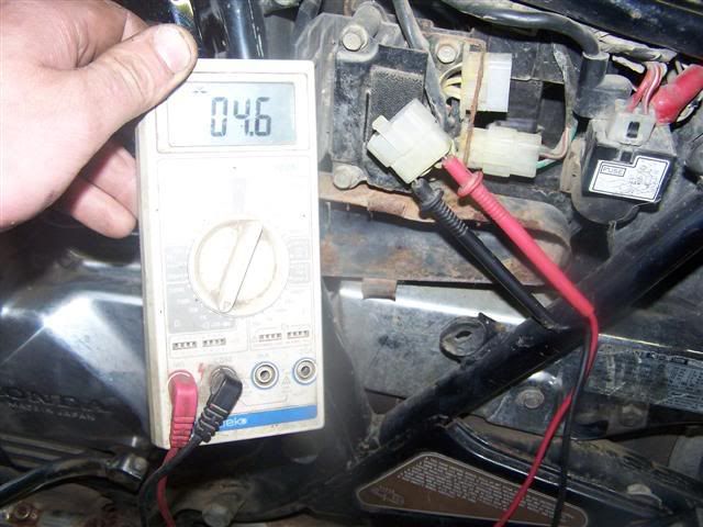

good news...
clean off the brushes and slap her back together,with that pretty new gasket...
thats what im doing right now(except for the new gasket,)as soon as she is back together ill measure black to white wire again,should read around 6 ohms then..
martino1972
Re: 'flat part' on starter... oops, maybe it's the charging system!
« Reply #59 on: August 04, 2008, 04:46:09 PM »
got it back together,and looky what it reads.. ;D ;D ;D
hope you have the same results...

Wiggled and everything tested out ok, hooked everything up and got a reading of 4.9. :D  Right On!
