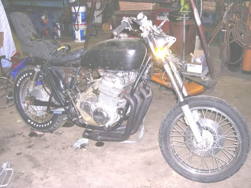

Hey, it was a freebie....
Previous owner said he rode it home, tore it down for a restoration then had heart surgery. Sadly he couldn't finish it.
The plan is fire the motor, check the clutch, alternator, transmission. (EDIT-Should have included pull the sprocket cover and make sure a broken chain hadn't busted the transmission case :'()If everything checks out OK, then buy a few parts and de-chopperize it. The forks and the king/queen seat have to go!
After all, this is the 90's, right?
I must say, after lurking on this site this week, I'm quite intrigued with the cafe' racer look.
Picked the bike up as a rolling frame, engine out, fenders off. Had been sitting outside a couple of years. The frame was in the open, at least the engine and parts were under a tarp. It looks 85% there.
Swung the engine back in the frame, waiting on two 6 x 75mm machine bolts that were missing for the valve cover before I can really bolt the engine in.
Electrical system was horrible. I've been repairing wiring today that basically was OK to begin with. Carburetors were as bad as you could imagine. A little Gumout spray, dipped the small parts, hopefully it'll start and run with this B/Y overhaul.
If the motor won't fire or has serious problems, gonna whore it out on ebay. ;)
Any comments, suggestions are greatly appreciated.

Needles belong in 2nd notch from bottom on K2,
Mine were in the lowest notch. I noticed when I would rev the motor I would get a puff of black smoke. I read where the "default" setting was the middle notch, that's where I put them.
put them there and leave them. Main jets should be 100 to 110 size, depending on altitude. If you are outside this range, something else is wrong in the carbs.
These are 125 mains and 41 idle jets but I have K&N's and a 4-1 header. I haven't done any WOT plug reads, but crusing (4-5K RPM) the plugs are colored perfect.
Most likely culprit: there is a hard-to-clean air passage in the carbs: it runs from the air horn to the mainjet holder (the threaded casting in the middle of the bowl). Unfortunately, it starts out in a right-angle turn, right after the tiny brass port at the air horn (you can see the even tinier brass cap that blocks the drilled passageway, below the inlet port), so use a soft mechanic's wire to run it thru and solvent to clean it: mine took 4 passes to clean out. With those individual air filters, these holes plug quickly: a stock airbox, with its built-in velocity stacks, helps prevent recurrence. I have a post about this somewhere here, may try to find it for you.
I know the passage you're speaking of, I used lots of compressed air and carburetor cleaner but didn't try to use a small wire.

I am thinking you may have a wheel trade underway, but if not, run the 16 in rear a while..some prefer them.
Honda man suggests 110, but your combination is known to run well with 115 oe 120 jets.. cant hurt to try..
I'm going to keep the 125 jet in there until I can do some WOT plug readings... But not with the present tires.
Do you still have lathe access?.. i bet you could work most of them dents out of the pipes, if you make a set of balls with a hole drilled thru for a cable.. get them down into the pipe with something flexible or curved. Then work up to a bigger ball a bit at a time.
Funny you mentioned that. I did work the two most noticeable dents out of #1 and #4 head pipes. Tapped them out with a blunt 1/2" bar then gas fill welded/ground/filed the area smooth. I couldn't replicate the surrounding area rust pits though.
Later I would like to buy a set of the 4-2 Mac headers.
BTW, noticed a lot of white, crusty deposits in the sediment bowl/screen and the main jet holder/well that weren't there last month... WTF could it be?
