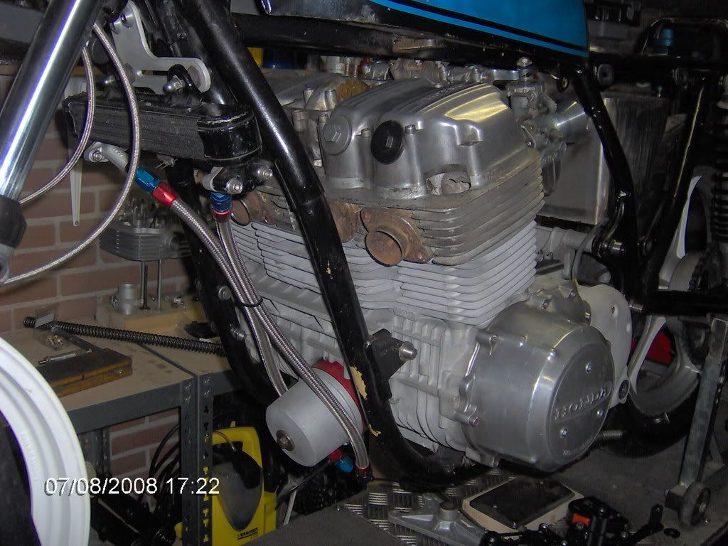

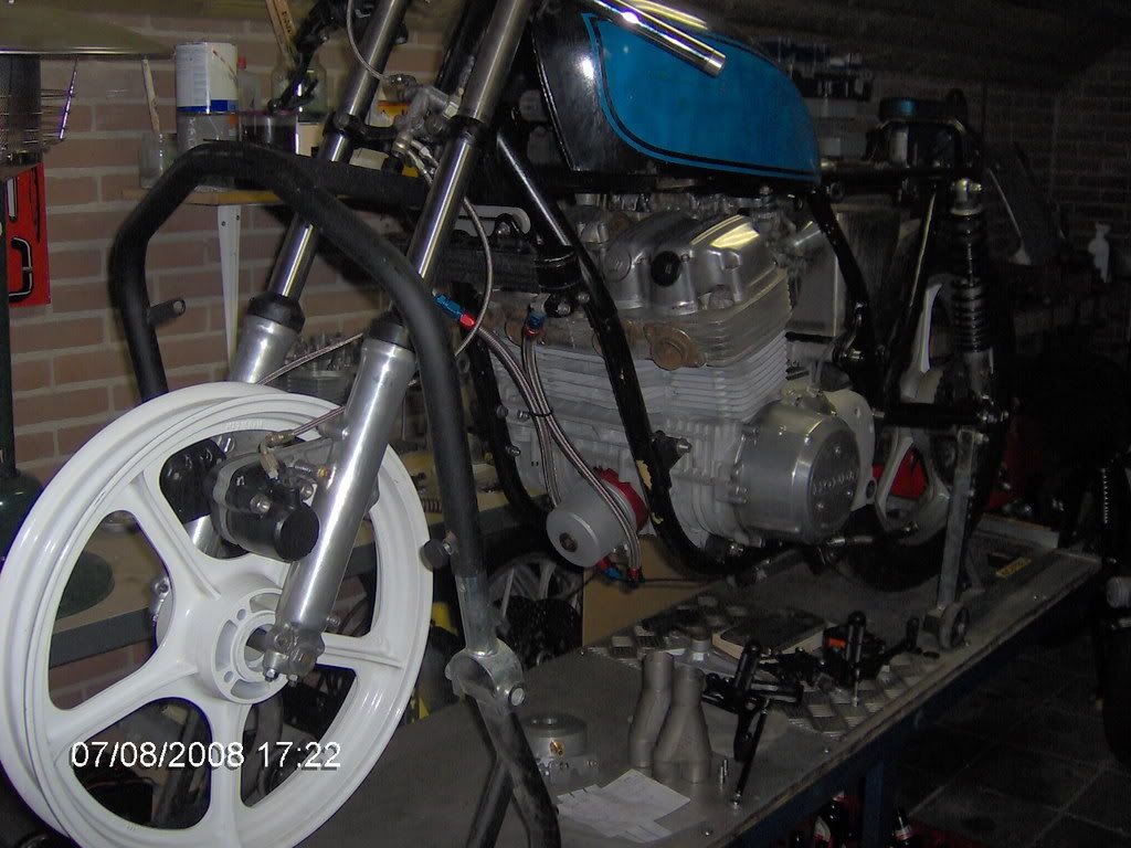

Maybe your interested in my new projekt, will show the progress of it here. Some of the first pic's:
This is my 'mock-up'engine. This baby get's a K7 engine with 850 kit. Am trying to make her lighter then original in a lot of area's. Also get some of my own, and others, feature's. Use of Honda related parts if possible.

Nice looking project you have there Rob, were did you get the smooth oil filter housing? cheers Mick.
Hey Mick,
Thanks mate, Is not a K0 type but a ordinary K2-K6,K7,F1&F2 that I changed on the lathe. Looks nicer than the original one, I think.
Cheers, Rob

« Reply #4 on: August 09, 2008, 02:38:13 PM »
Hey Mick,
Cheers, Rob
just thought I would mention, if someone likes the look and copies it, the finned oil filter acts as an oil cooler, you have an oil cooler so not a problem.
Malcolm

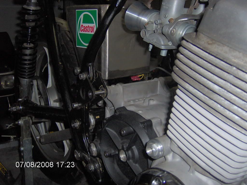

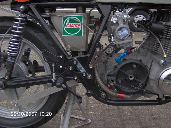

More info on that oil tank. Homemade?
I'll probably be building one this winter from aluminum that fills the entire center triangle on the bike. It will have a recess in the center for the battery and the electronics will be relocated under a cafe seat.
Steve
Hey Steve,
Yes ,it was my first attempt on oiltank fabrication. It's made from Stainless 304 and uses the original feedline and have positioned the return upfront.
The last one also has a recess to take the battery.
Cheers, Rob
