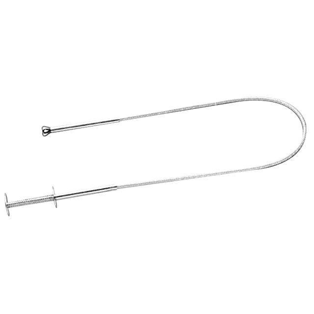

Remember that game "Operation"  where you tried to extract the patients bones with a pair of tweezers without setting off the buzzer?  Yeah... it was going to be like that.
All I can say is God bless the man who invented the "magnet on the end of a rod" device:

These "pick up tools" are priceless:

i have one, they are great.  they always remind me of the movie Total Recall, when Arnold pulls that thing from his nose.
