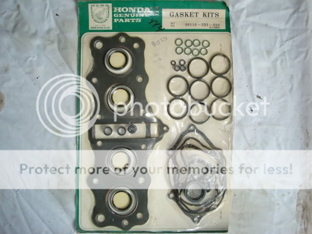

OK Guys.  Cylinder block, head, and pistons have been dropped off at the machine shop.  He said he will get to them next week.
I got my gasket kit today:
Holy Schnikeys that's alot of little unrecognizable (to me) parts!  There are the obvious ones...  by the shape...  and then there is a schikload of other ones.  Can I count on my smart friends to help me identify what goes where when the time comes?   ::)
I guess while I await the results from the machine shop, it would be a good time to tackle those carbs.  I have heard some people say that you can keep 'em all hooked together and get the job done, saving much headaches from having to put the assembly back together.  Thoughts?

Here I had a thread bookmarked with pictures identifying all the gaskets in a set for a 400 and now it doesn't work. I did a search and couldn't find it either. I tried.

I got K&L kits for my 350F, but I had a problem with the carb bowl gaskets swelling after I took them apart after the rebuild to change jets.
K&L and Keyster kits are virtually the same but the costs are different. I got them here http://www.siriusconinc.com/default.asp but you can get them at many places so shop around.
Here's a pic of the K&L kit so you can see what comes in it. Just be sure that if you get an aftermarket kit, use the original Honda 'needle' as a few members have found that their profiles are different.
 Matt.

OK.  Time for one of those embarrassing questions that you guys thought everybody knew the answer to...   :-[  Where can I get replacement O rings (short of buying an official carb overhaul kit?)  Hardware store?  Will the right size to get be apparent? :-\
It will have to be a pretty complete service hardware store to sell those metric orings.  They are NOT standard plumbing sizes.  Of course, the right ones are in the honda gasket set.
I think Kevin400F had some orings to sell individually.  You could PM him to verify.
