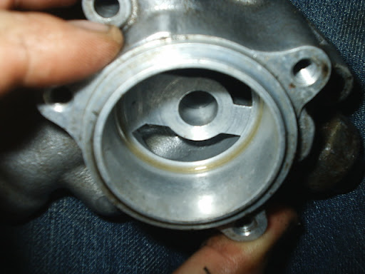

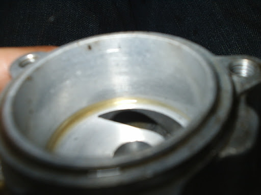

Well, there's plenty of meat. I just don't know where you'd start (This is off of a '77 550k)

Maybe I'm just dense, but I wouldn't know where to start with the 550 pump. I think I'd want to get a couple spares before I mess with it.
