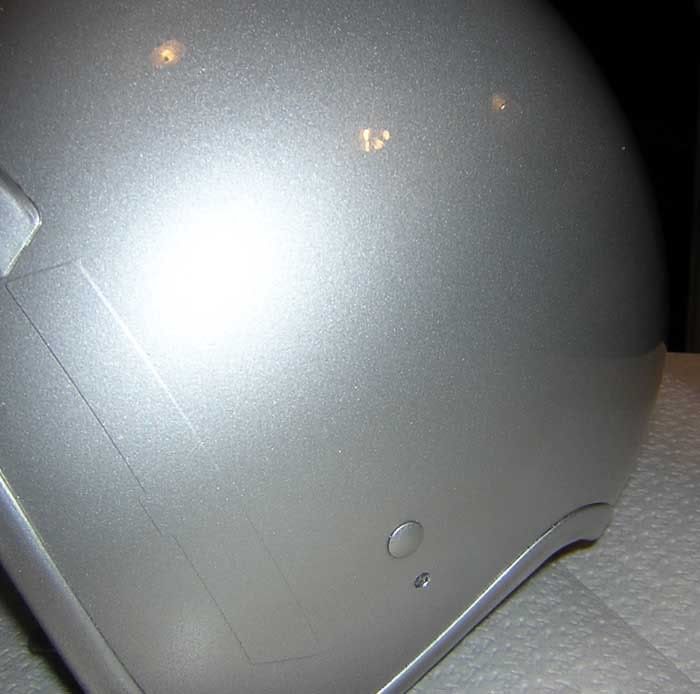

Well, the cool news is that my small air compressor is sufficient to run the mini gun. It seems to spray nice. I just went for it and tweaked the gun as I went along. I think I did it right, I sprayed back and forth slowly, but not too slowly, overlapping a little as I went. I continued until the paint started to look like glass, then stopped. Maybe this is too thick of a first coat. I dont really know what the first coat should look like. Hazy?
I used an old helmet for practicing over curves and angles. I didnt prep it obviously by the little chunks of stuff here and there. The paint is PPG Shopline single stage urethane. Anyway, here's the color I picked out. I think it's going to look really nice in the sunshine next Spring.

« Reply #1 on: November 19, 2008, 08:09:08 PM »
sweet... gotta love the first time.   ;)
if you think its a bit thick, i can pretty much guarantee that it is... 3-4 thin coats 10ish minutes apart are way better than 1 thick one.

yeah I would agree and say its too thick,  Its deffinetly better to spray more thin coats than less thick coats.  And with spraying thicker coats you run the risk of getting runs and drips in paint which is not a good thing.  Keep it up though and good luck

Thanks for the tips. I guess that's where my trouble comes in. The paint I have is single stage and it's metallic. The clear is mixed with the paint and I hear youre not to suppose to buff this paint afterwards. It only needs a good coat of wax in about a month.
I hear what you're saying about the fuzzy's. To me, that always looks like it needs just a little more paint. Too much after that point and it'll start to run.
Maybe Im in over my head, but I really want to learn so I can do more in the future.

The helmet look very good. Fuzz is bad, Fuzz is dry spray. Why buff such a small part. Just put a little more thinner wait like I said between coats, just put enough paint to make it look wet and stop until the next coat. The first coat should be the lightest one 3 coats should work fine. I NEVER have to buff any Motorcycle parts. Now cars are another story. Tattoo

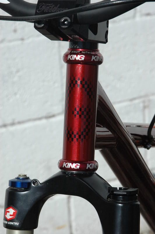

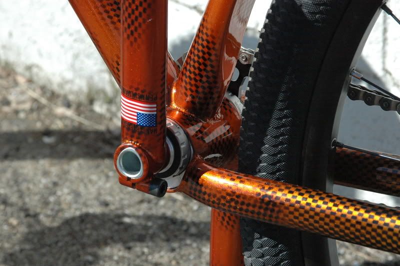

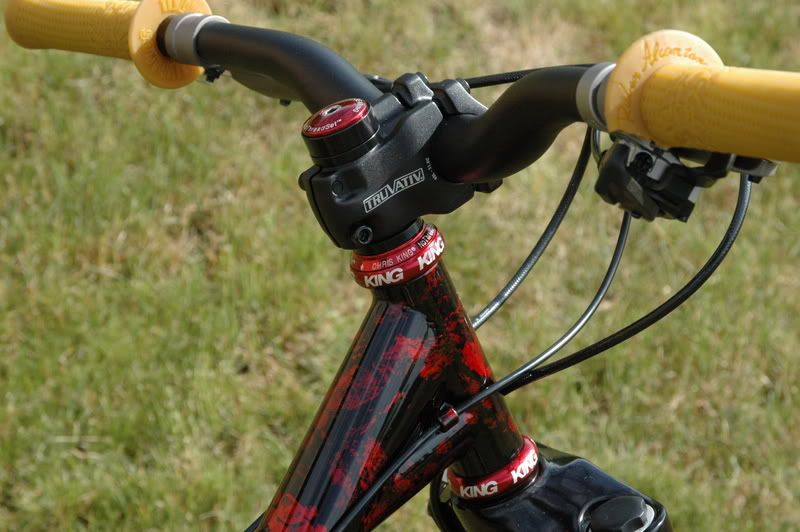

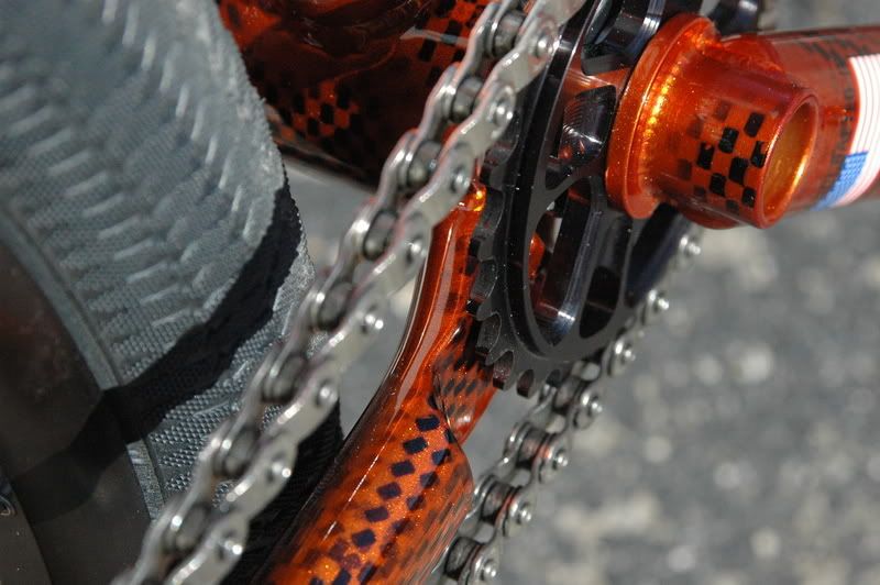

I've had my fair share of paint experience the past few years.. my dad painted professionally for a good portion of his lifetime.  Having a paintbooth in your basement is kickass!! ;)
Some of MY work...
Well... Pic crazy, but I know how much you all dig pictures on these boards ;)  Sorry for the off-topic-ness of the post.  Maybe some of you manual two-wheeled officionado's will appreciate it a bit more.  That's my main hobby, the fabrication/design of bike frames, etc.  I built and designed both frames myself (minus major welding), and did all the paintwork.
All that we shoot is PPG with the ocassional house of kolors... Honestly, I can't even begin to describe how "thick" to lay the paint. It comes with experience, practice, and "seeing" it many times to get a feel for it.  I've been painting for a few years now and I still don't know what I'm doing compared to my pops!!!
