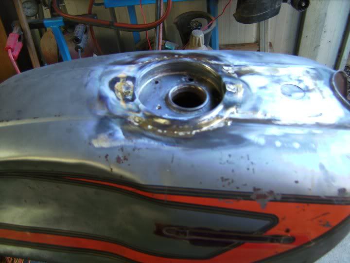

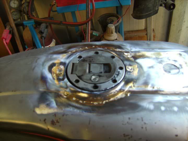

Here's a tank I'm "modifying" for Sean Condon, I'm only brazing in any mods like the race filler, I'm a much better mig welder than I am a stick welder, but brazing is a lot better filler than mig, and a lot easier to grind into shape, if necessary.
This tank hasn't held fuel for a long time, and when I got it I removed the cap and let it sit for a few months (winter) but having said that, I've welded tanks within minutes of removing them from bikes.
