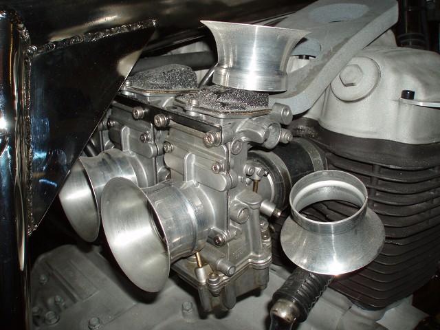

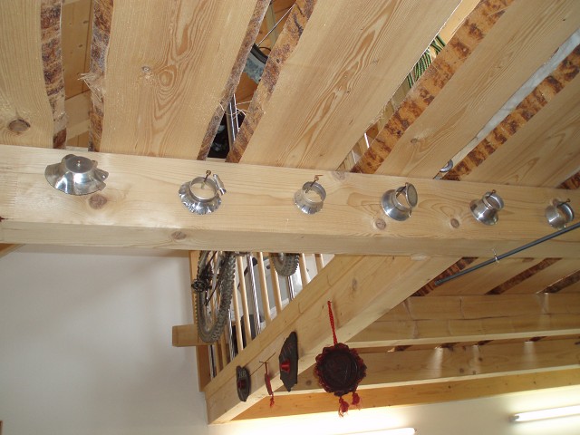

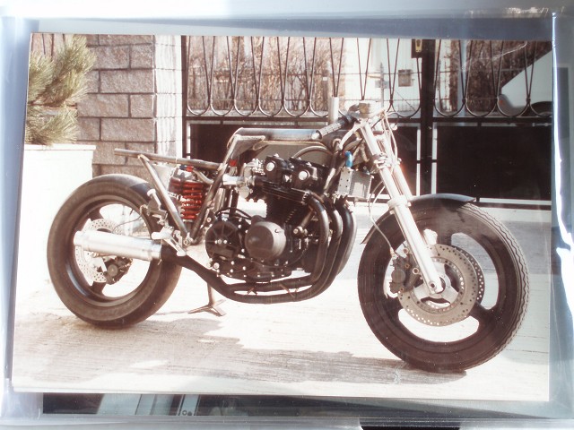

inspired by another thread called "velocitiy stacks", a few words on that:
in the 80ies I ordered hundreds of these stacks for various bikes, all lenght from 30mm up to 70mm, for the sohc, bol d´or, kawa 500 up to Z1, a.s.o..
all worked, if rejetted properly. the shorter ones gave more high rev power, the longer ones low range power.
an old man allowed me to have a look on how these stacks are fabricated. it was fascinating and I never had forgotten the dream to make them by my own.
my first tries failed. the breakthrough came with a DVD called "metall spinning workshop" by Terry Tynan (http://www.terrytynan.com/metalspinning.html).
this picture show my first attempts:
learning by doing
the seventh attempt looked like these:
mec

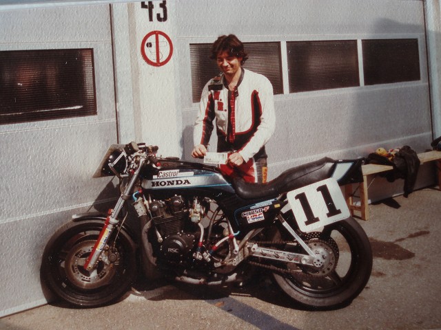

hello,

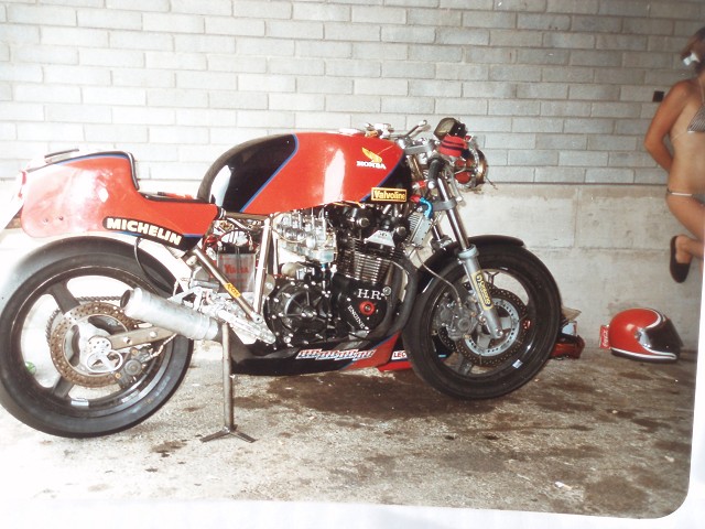

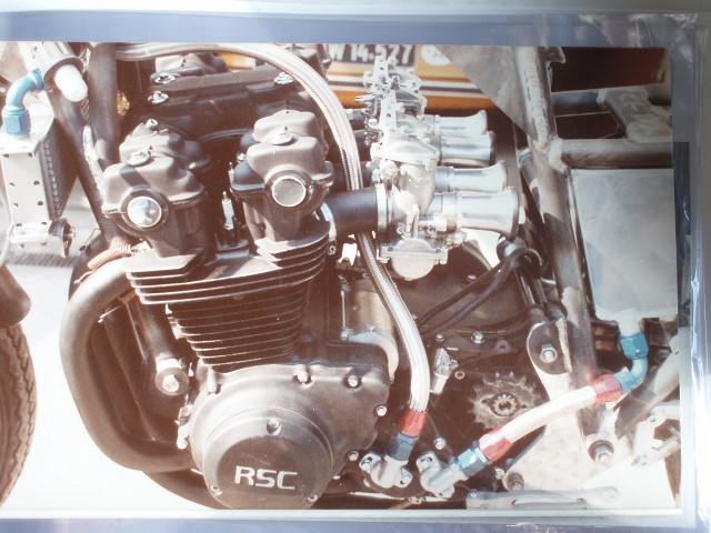

in another thread I have seen a beautiful CB 900 from voxonda. but some members had not been lucky with this bike. therefore I had the idea to bring some photos of my old cb 900 in the meantime.
to my mind, it was not a bad bike. unluckily the bike was much more expensive to race than i.e. a Z 1000. all the race-kawas had been bored up to 1200ccm, had been reliable yet and very, very fast. with an extreme effort I brought my CB 900 to beat the kawas.
the engine was a stock cb 900 case, 1130ccm, bigger valves, racing cams (RSC or Andrews?), carillos, RSC dry sump lubrication, RSC dry sump, close ratio gearbox, Keihin CR 31 or 36er Lectron (does anybody remember, the carbs without any nozzle). this setup was strong enough to break the (new) primary chain within 4 laps on the salzburgring-raceway. therefore a RSC crankshaft (lightened and balanced by Höckle, Germany) with the wider primary chain and primary drive sprocket was implanted. now the engine was really strong and reliable too.
25 - 30 years ago:
Lectron 36 carbs
same bike with race fairings, alu fuel tank and carbon/kevlar rear seat (grid girls looked the same as today :)) :
frame was done by a friend of mine (hello peter!! thank you for your excellent work):
here with the famous CR 31
all the RSC stuff was brought to Austria by a friend of mine, who travelled to england several times a year. I do not know, where this stuff comes from (Harris, Spondon??), all the engine covers in magnesium, detto oilpumpcasing and sump:
overall weight of the bike ready to go including oil (without fuel): 169kg
some more specs: Dymag Magnesium wheels, Spondon front fork, DeCarbon rear mono shock.
I regret that a have sold the bike of course. last year I met the owner surprisingly. but he is not willing to sell the bike  :(
mec

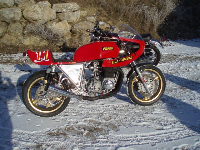

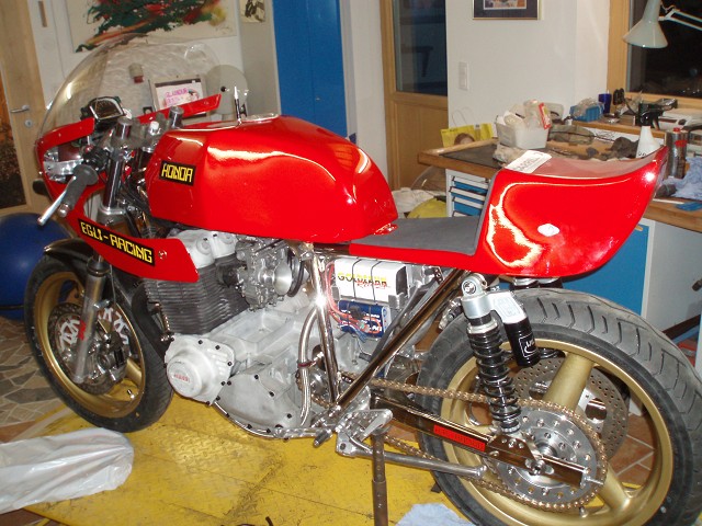

« Reply #61 on: January 17, 2009, 10:47:16 AM »

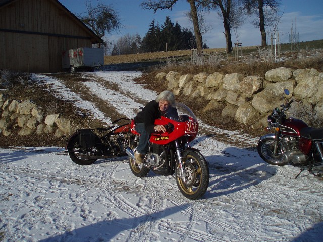

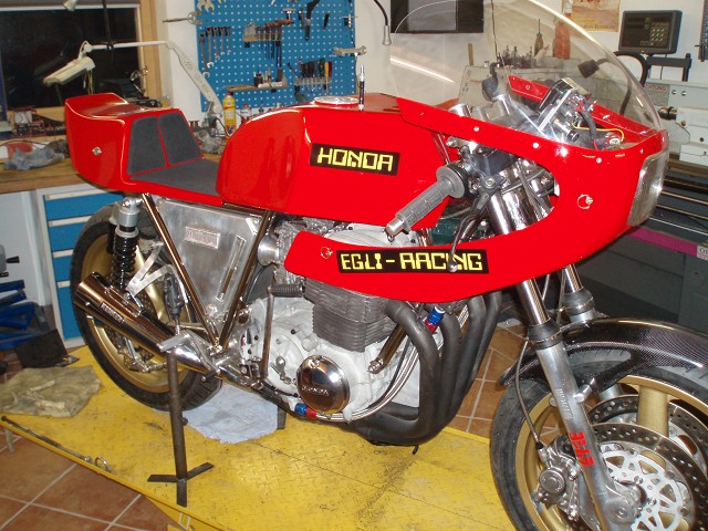

hello,
the wait is over. the painter did his job very well and most of all really prompt.
on the down side I see this project coming to an end  :(
getting all the painted parts I started to fit the fairing glass, rear taillight, fuel cock.
the upper fairing mount is still to be chrome plated.
all the painted stuff came "ferrari red". all other colors are decals and do not harmonize all together. the black/yellow egli decals are a must. all the others should harmonize in some way to the red/black/yellow mix. unfortunately the "carillo" decal is a white one (and others too). therefore I tried to bring some white color and used the number 11 in white. this does not match the red/black/yellow.
I hope I will find a better solution in the future.
same for the silver quick fasteners (fairing) and black fairing glass mounting screws.
nevertheless there are the first pixs:
here relatively decal free, maybe the best looking.

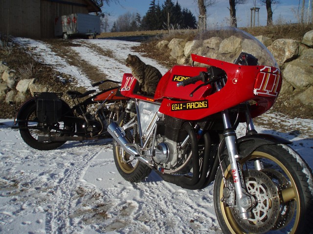

background K6
[img[http://www.reitprecht.at/images/hobby/Motorrad/Eigenbaurahmen/k-P1170011.JPG[/img]http://my friend peter´s sohc egli in the background:
fritz the cat as a pilot, in the back my Indian Scout 1930:
unfortunately too cold for a ride
live in peace
mec

can't stop drooling ...  great job mec .    like you, i think the decals look slightly out of place, but i totally agree they are a must have

Mec, ein vorschlag... have you thought of getting the long egli decal made of vinyl, and curved to follow the fairing edge, just a rhought, it would fit nicer.

Oh mec. I think the bike is now beyond hope; those graphics just destroyed an otherwise perfect machine. Nothing to do now but give it to me.

the long egli decal is the first that will be removed and replaced by a curved one, you are right.
