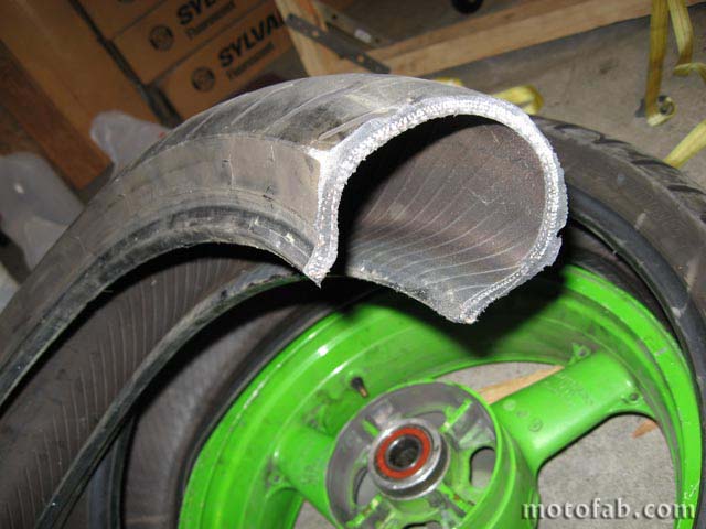

A lot of tire go on easy without tools, getting them off is the hard part..
Ruglyde is your friend.
Learning how to keep your bead to the lowest part of the rimwell is the whole trick in the operation..

Strictly speaking, it looks like he's using 8 tools to avoid using 3 tire irons.

True, he just swapped the tools used, but he also prevents the accidental slippage marring the rim/paint, your teeth....

Now back to the previously scheduled discussion about non-traditional methods for mounting motorcycle tires.
I have worked in and managed bikeshops, and I have mounted many, many tires.  I also have traveled many, many miles on my motorcycles and had have had to actually change a tire (inner tube) on the side of the road out in the middle of nowhere.  Sport tires in general are extremely difficult to mount at home.  Likewise, trying to mount a tubeless tire onto one of our spoked, tubed rimes often also is very difficult.
In all honesty, I have no idea if the above posted pictures would work well on one of our bikes, but I do know that it is a clever idea. I also know that if you have ever tried to mount a tire in your garage, you are intimate with the fact that modern motorcycle tires really need better tools than a tire iron or two.  I have custom built 'big truck' tire irons (they are HUGE!) which I reshaped in a machine shop so that use them to install bike tires at home.  Let me tell you... it sucks!  Next time I try to do it at home I will try this thing with straps.

are those regular tiedowns in the pic? I guess if it saves scratching a rim it may be worth trying... which gave me a new idea..
What if you used 6 or 4 in wide shrinkwrap (heavier mil may work best), then wrap tube/tire tightly, then instal.. Then go along the side or tread(be killer if you have a center groove) with an exacto knife and slit the shrinkwrap :o

Tire irons may be easier to pack that 8 or 10 tiedowns..
For those up in Frozen Canuckia, Princess Auto has cheap tire irons, hope they are not the bendy type.. might be worth checking them out...

Not to brag or nuthin, but in the time it would take to install all those straps, I'd have a tire off and back on.  That's with 3 tire irons and the great RuGlide.  Using RuGlide, many times the tire can be installed with just hand pressure.
