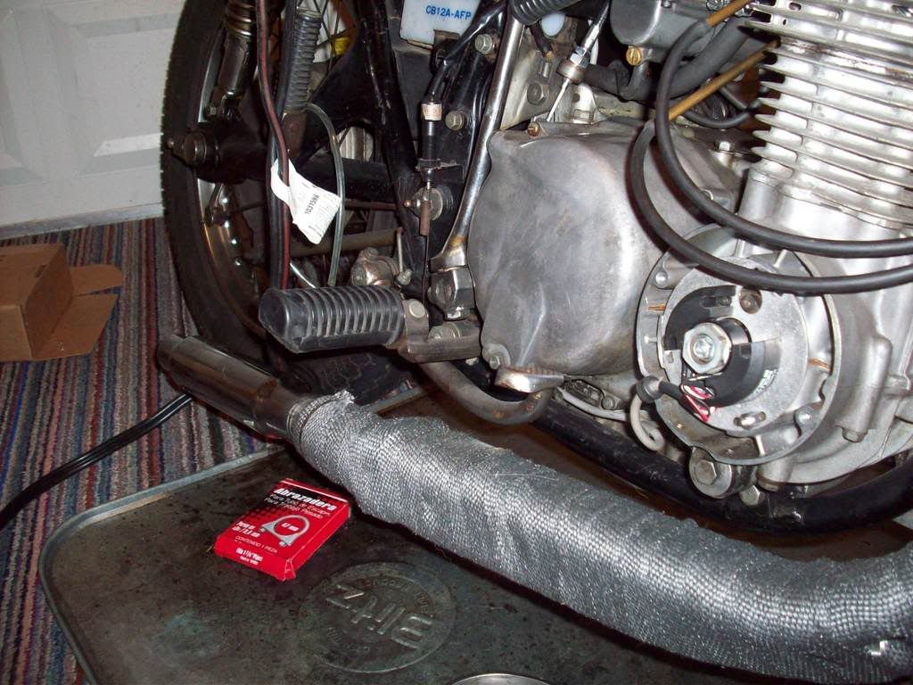

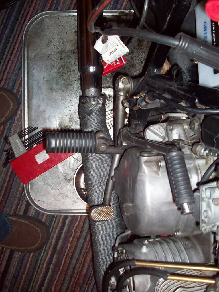

« Reply #4 on: February 09, 2009, 10:22:07 AM »
Offline NickC
  • Posts: 703
Re: 1975 cb550 k , will the same year 550 f 4 into 1 pipes Fit the k?
« Reply #5 on: February 09, 2009, 11:10:58 AM »
What I did was bolt the pipes up, used an oxy- torch to heat up the pipes nice and red, put a breaker bar into the end and bend as needed. I can stand on the brake as hard as I can now, and it barely contacts the exhaust. This bend does create a kind of akward position for a muffler, so I am going to have the muffler shop bend an additional piece to create an "upswept" position for the muffler.

thanks nick, do you have a pic , where does the pipe meet the peg on the single tubes or after they go into one????
Offline NickC
  • Posts: 703
« Reply #7 on: February 09, 2009, 12:03:25 PM »
I'll see if i can snap a pic this afternoon. I am ALMOST certain the pipes are off an F bike, but not 100%.
The brake hits a few inches before the pipes meet at the collector.

Thanks broshi. I can see now the difference in the brake placement. I'll see if i can get a pic so other can see

It appears the F brake pedal comes much further out from the frame vs. the K. There is no way the exhaust would fit between the frame and brake like the F
